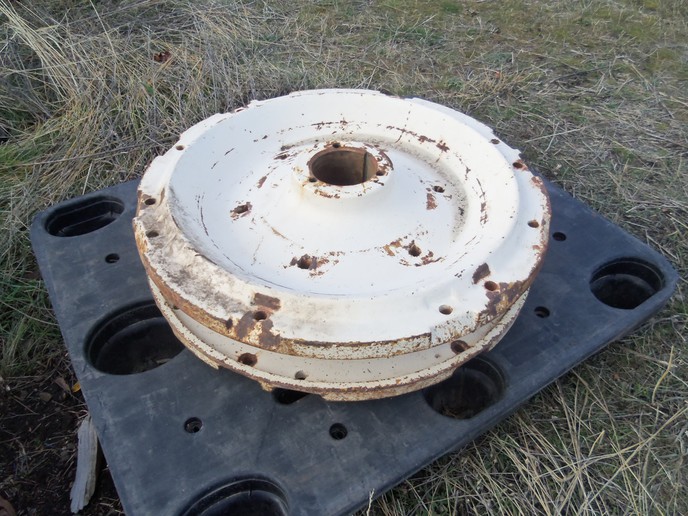

Anyone know the road speed for a D-19 with 18.4x34s? Also can 38 power adjust rims and tires mount on a 34 cast center? Any special step adaptors like I have on a 4020 to mount 38 rims on 34 centers? Al

You would need the right center for the rim. No way to step up.

Al. they used to make the spacers to do that, I did a couple in the mid 1980's. But I havnt seen any of them for a long time. You might find some at Hutch or the Missouri AC swap meet the first week in March. Have you asked on the Unofficial Allis website? Good luck with your search.

Step down rims are no problem to find. Step down power adjust is virtually impossible to do. If the hub pattern is the same, finding a set of 38" with centers from a bigger machine shouldn't be too hard to do.

A 38 inch cast rear wheel center from a D-19, 190, 200, 7000 or D-21 will fit on that D-19. The axle is 2 3/4" same as an old 190. Just use your current 2 3/4" tapered axle bushing and any wheel center will fit.

I have a set of 38" centers I'd sell for $200
