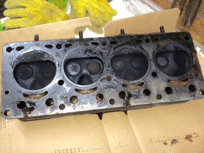

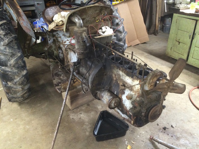

I've had this TO-30 for several years and use it regularly for light duty tasks on a farm. When I purchased it there was an issue with coolant use and when first started after sitting it would run on three cylinders for a short while and exhaust some white fog. I just kept the coolant topped off and since it's not used hard just lived with the problem. Recently the coolant issue has gotten worse and the engine suddenly developed a leaky rear main seal.
So it's time to address the issues. I pulled the head today expecting to find a cracked block but hoping that a head gasket might cure the problem. I found a broken valve spring on #1 exhaust. I found coolant in #3 cylinder but no obvious route from the coolant jacket to the cylinder. I see no sign of any cracking associated with the block. The head gasket shows deterioration between #2 and #3 cylinders, but no leakage between them or from the coolant jacket to the area.
I'm going to keep going deeper. To replace the rear main seal will require near full disassembly. Hard to say what I'll run into associated with main and rod bearings/crankshaft condition. I'd like to return the machine to good operating condition with the minimum of money spent.
I'd solicit any suggestions from members here about proceeding. My current plan is to remove the oil pan and pop the pistons out. The cylinders exhibit minor wear near the top, I've seen worse and if I don't find any real problems I'll hone and re-ring.
The rear main seal worries me - the engine has been decently oil tight, then suddenly there was a small but steady stream of engine oil exiting the bell housing - not a drip, but a stream. It seems to be all or nothing, sometimes it would start and run and no leak, the next time it would pump out the engine lubricant in a couple of hours of running. Dunno - All I know to do is look at the area, evaluate the condition of the crank and bearings, and replace what's necessary.
some pictures for you

Lay a straight edge (carpenters square) across the head; I am betting you will find it warped. How was the oil pressure? I am
betting the coolant wiped out the seal and maybe a bearing or two. Long time ago I saw a drilling template for a Ford, but don't
know about a Ferg 30. Cast iron will not drill bad. Pilot hole and good sharp bits.

The head gasket was obviously leaking, that explains the coolant in the oil and #3.
The rear seal streaming oil will be real difficult to properly repair without pulling the engine. Likely
there will be some crank and bearing damage from the contaminated oil, or just from wear.
My suggestion would be to go ahead and pull the engine, get it out where you can see what's there. It's
really not that much more work considering the option of laying under it with oil dripping in your face.
Something else, if you are not aware, the cylinder liners just sit in the block with oring seals at the
bottom. If any move up, the seal will be broken and the liner will need to come out to be resealed. Not an
easy job when sediment from the coolant gets under the liner!
Those seals really need to be replaced anyway, at their age they have to be deteriorated.

yes - with the rear main seal issue there's really no option but pulling the engine -
I worked this evening getting the block de-accessoried and the front suspension out of the way - tomorrow I'll have to set some vehicles outside (it's winter here again, cold and snow) and dig the engine stand out of the loft -
it's going to be real easy to get more money wrapped up in this than the machine is worth - there's no place to stop...

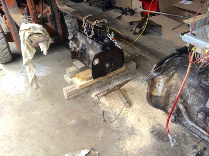

We are having fun now -
I did find the rear main seal issue - spring that holds it tight around the crank was broken -
I am happy with what I've found, generally - the bearings look like new - - I'm thinking about things, but I'm inclined to reuse them - they are standard bearings - I am up against lack of tools now, I don't have a set of micrometers that can check the crank and rod journals - I'll have to either borrow or haul the crank somewhere -
I don't see any sign of the block cracking at the lower end of the web - rod bearings look just as good as the mains, I haven't examined the pistons/wrist pins closely yet, but it seem likely that I can buy a set of rings and get back in business -
Someone mentioned pulling the sleeves and resealing - the sleeves are sealed to the block with o-rings? o-rings of the sort that are available at a hardware store? I'm not opposed to doing that, but I'm not looking for trouble either....
I've got to decide about the head - there's a broken spring, so do I replace that, have the head ground flat and move on, or go all the way with guides, springs, valves, etc? -
dunno - usually at this point I go all the way with things, clean-up and paint, etc, but it's difficult in freezing temperatures - I can't get the pressure washer out and it's going to be too cold even for the carwash for the foreseeable future -
dunno - what do you all think?

It's nice to see you are getting the vanilla pudding out of there.
Auto zone usually 'loans' tools, it shouldn't take you long to mike everything with a dial caliper. It looks good from the pics.
The o-rings and springs might be available on this site's online store. You need a gasket set at the least, but yeah, while it's this far, do the o-rings now. Leaks are a big sore spot on this model. And might as well get a new clutch while is down that far too.
