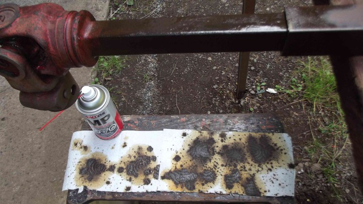

In the interest of full disclosure . . . Smile
I used heat on that Coulter collar first
but it is cold in the photo where I dribbling MP over it -- without brushing too just to show. But of course brushing speeds things up and saves MP.
This time, no heat so it's good example of actually dissolving unheated rust, gum or corrosion like in your engine.
It's half the drive shaft of my MF Rotary Cutter

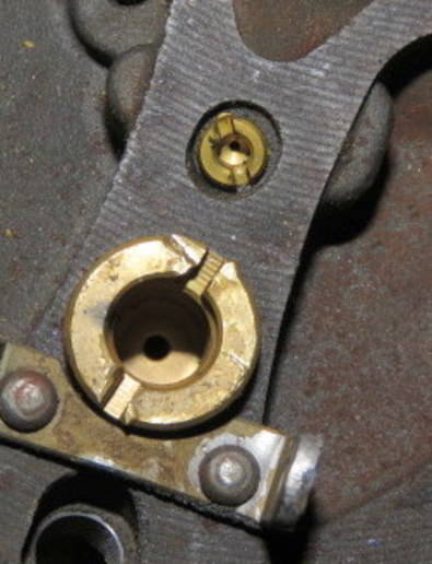

Very Happy Very Happy Woohoo!! Very Happy Very Happy The motor is free!
After soaking overnight in PB Blaster, I put it in 2nd gear and gently rocked it back and forth. On the 3rd try, the fan pulley turned slightly. I put the Farmall Cub starter crank in the fan pulley and gave it a tug. It moved about a quarter turn. Another tug moved it half way, and the third tug let me make an entire revolution of the hand crank. I hooked a battery to it and spun it over a few times, enjoying a brief PB Blaster shower! Covering the spark plug holes with a rag, I spun it a couple more times. I got my compression tester and checked each cylinder...120 in #1,#2, and #4, and 95 in #3. Not too bad, right? Maybe once it's running, #3 will improve. Thanks to EVERYONE for the suggestions and advice. I really appreciate your kindness!
Now for another problem. After soaking the carb overnight in a bucket of carb cleaner, I disassembled the carb very carefully. Youtube was a big help with this procedure. The larger brass jet in the top of the carb was a bugger to remove, but persistence and PB Blaster finally paid off. However, when I tried to remove the recessed smaller jet in front of the large one, I destroyed the screwdriver slot. It is so very stuck, and the brass is so very soft! Can any of you gurus out there help me? I am open to suggestions. Is it possible to VERY CAREFULLY drill the soft brass out without ruining the cast iron? I have ordered a rebuild kit from ytmag, but I have to get that smaller jet out before I can replace it with the new one. Other than that, the carb is cleaning up pretty good. Man, that varnish/tar/goop is tough, but I am slowly scraping and dissolving and scraping and dissolving it all out.
Thanks again for all the help thus far!

I got excited to hear your engine broke free. If worse comes to worse. And you do have to drill out your jet. You could get a left hand drill bit. That way when you start drilling- MAYBE it will turn out. Harbor freight has them- I looked it up and theirs one 24miles away from Mills FL. good luck.

RUHokie wrote:

If you an get the jet clean and the passage way is clean, leave it there. ethis the one you are talking about?

Yep, that's the little bugger! Mine is recessed down in the cast about 3/32 of an inch, and is really tough to get to with any screwdriver of size. I was using a gunsmiths screwdriver when I screwed the pooch.

That is the idle jet, the thread size is 10/32.
good luck, the one inmy photo came out pretty easy.

So, if I end up having to drill it out, what size drill bit should I use? Would a 5/16ths be appropriate or should I go smaller? Hand drill or drill press? I think drilling it out will be a last resort.
