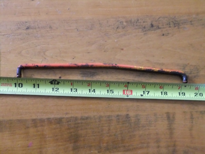

RECENTLY PICKED UP A 1952 ALLIS CHALMERS I-B. IT IS MISSING THE ACCELERATOR LINK (PART #219939) IN CHECKING NUMEROUS PLACES UNABLE TO FIND ONE. DOES ANYONE KNOW WHERE I COULD PICK UP THIS LINK? ANYONE WITH THIS LINK IF THEY COULD FURNISH MEASUREMENTS, LENGTH, DIAMETER, ETC. THEN I COULD POSSIBLY HAVE ONE MADE UP. ANY INFO.WOULD BE HELPFUL AND APPRECIATED. THANKS

Hi GSCZEPANIK,
I don't have a parts book but I do have an IB and I think I could get you the measurements. Can you take a picture of the area you are talking about on your tractor and then I should b able to figure it out.

I checked my parts book. He needs the first rod from the foot throttle to the L shaped lever. Simple rod with 2 90* bends on the ends.

PostPosted: Mon Feb 26, 2018 2:51 pm    Post subject: Re: ALLIS I-B Reply to specific post Reply with quote
GSCZEPANIK,
Attached is a picture of the rod. The rod is made from .250 round stock and measures 9.25 total length. One leg measures .385 and the other measures .500. There is slight bend in rod that you can see as the gap increases between the rod and tape measure and closes.

I WANT TO THANK YOU ALL FOR ALL THE HELP. I TOOK THE PICTURES TO A FRIEND WHO HAS A MACHINE SHOP AND HE IS GOING TO FIX ME UP WITH THE LINKAGE FOR THE ALLIS IB. THE ASSISTANCE BY ALL OF YOU HAS BEEN GREAT. IF AMY MORE QUESTIONS COME UP WITH THE I=B WILL POST IT ON THE FORUM. THE MEASUREMENTS WERE A GRREAT HELP.......................GARY
