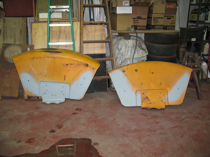

pulled the bent fenders off and sent them to my friend ericks for straightening, some before and after pics.

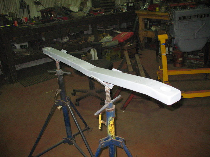

removed the tin work off the tractor, then pulled the bent up draw bar assembly off, found out why it was all bent up! the first owner had taken the draw bar out and installed it upside down?? why I don't know but (mabe to lower it for some implement?) being upside down it was putting upward force on the side brackets and slide plate bending and splitting them Evil or Very Mad so will need new side brackets and straighten the slide plate.
draw bar pin had an S bend form the draw bar not being square to the pin. sent the side brackets and slide plate to ericks for him to build 2 new side brackets and straighten slide plate. I built new draw bar pin and lock plate primed and painted.

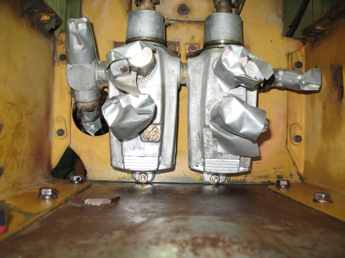

got the hydraulic control levers off and hoses and lines disconnected pulled the tank out, found 2 brackets for the charlyn valves laying in the muck in the bottom. one bracket was broken, cleaned everything up and the valves look ok, cleaned up the one good bracket and put it back on the bottom of the valve. those brackets hold the valve steady so they are not flopping all over (that's why the hydraulics were not responding like they should) now got to find another bracket and we will be good to go.
got the hydraulic tank cleaned up, took the filter out of the tank and cleaned it up (was actually pretty clean.) sanded and primed some pieces, levers, piping.

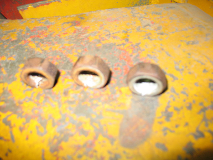

took the manifold off, large hole in it! used my nutcracker so I wouldn't break or bend up the manifold studs. the nutcracker splits the nuts open so you can just take them off with your fingers, and not wreck the threads.

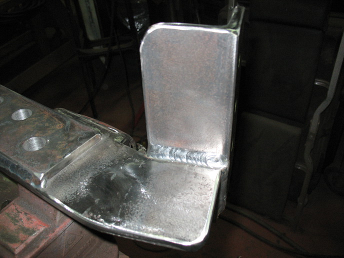

Erick brought the new side brackets and slide plate for the draw bar assembly, we installed them and test fitted everything, fits right on, the side brackets were built of wider angle iron and a plate added to beef them up. and so the bolt holes were not so close to the edge. ground the corners of the new brackets round so I don't cut my head or arms open sliding under the tractor Laughing
the old brackets for comparison
the new brackets prepped and ready for primer!

PostPosted: Thu Apr 19, 2018 6:31 am    Post subject: Re: progress on the m-5 today Reply to specific post Reply with quote
tjv in mn contacted me on here he might have the bracket I need for the charlyn valve, he went checking and found it! check out the restoration job he did on his m5 (beautiful) on the forum here. sent tjv some money and he shipped me the bracket and some other parts got it installed last night!

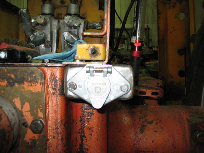

built a new power plug box for the back of the m5 (missing) and installed 5 pin trailer plug, (original was a 2 pin) the original was live from a 20 amp fuse on the dash, I will have one live circuit the same and one off a switch on the dash for lights. I plan on building a set of lights on magnets like the tow truck drivers use for towing vehicles and have them ready for my disc or cultivator if i'm coming home in the dark. also going to have a smv sign and dot reflector tape on the back of each, i'll be sticking to county back roads not out on any main highways but I still want to be SEEN Laughing

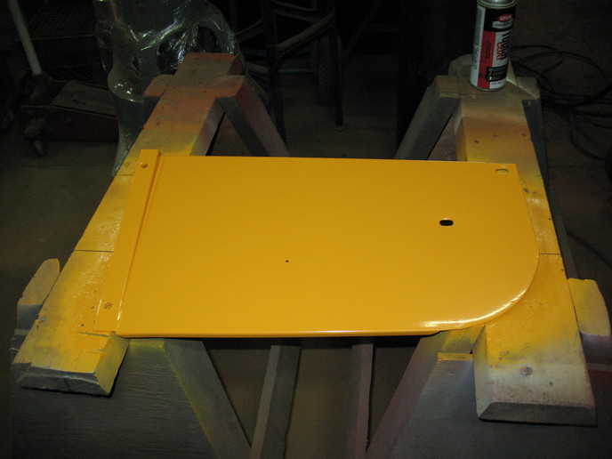

got some work done on the side panels under the hood today, welded up the cracked out bolt holes (vibration cracks) straightened the divots and wrinkles out of them. the 2 small panels by the fuel tank where nasty little buggers to get straight again! got them sanded down and prepped and primered.
