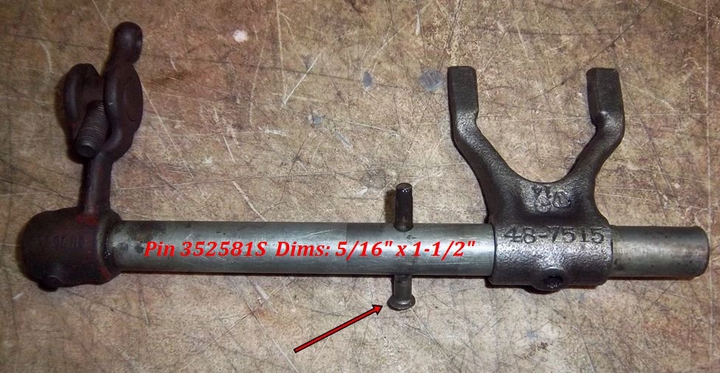

I recently purchased a parts tractor w/o engine or radiator ... to my surprise, when I started to unload it from my trailer, I noticed an extra transmission in front of the stock 9N 3-speed.
the shifter is on the right side instead of he left, and is made of cast iron...but straight, and not like the dog-leg style of the Sherman combo.
I`ve had the Howard before, but it was way different from the Sherman, and what I have...I`m not at all familiar with the Hupp trans and wonder if that is what I have...
It looks like I have to remove the shaft that holds the throw-out bearing to get the aux. trans out...but, I can`t figure out how to remove the shaft...or should I say the fork on the shaft.
Any help would be much appreciated...

PostPosted: Fri Mar 09, 2018 12:33 am    Post subject: Re: Non Sherman auxilary trans Reply to specific post Reply with quote
If you are referring to shaft/fork in photo, then all you have to do is disconnect the clevis assembly and rotate the clutch fork forward. This will allow you to slide the throw out bearing off of input shaft housing.

PostPosted: Fri Mar 09, 2018 7:31 am    Post subject: Re: Non Sherman auxilary trans Reply to specific post Reply with quote
Dollar Bill wrote:
(quoted from post at 09:33:46 03/09/1Cool
Dollar Bill,
Thanks for the photo...I have the throw out brg off; but the trans is too large to go over the shaft and fork...I`ll have to remove the front snout or bearing retainer to get the fork to rotate enough to get to the pin to drive it out...your pic helped in that I could`nt tell if the pin was tapered or not
