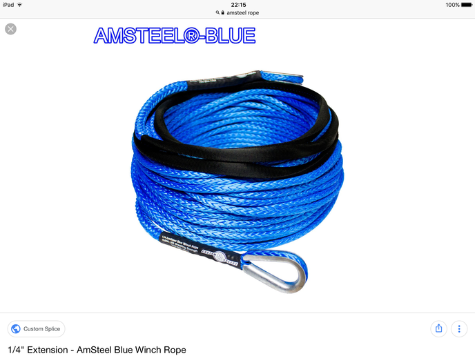

If you want a nice to handle, light weight, won't unspool, does not hold memory, etc. maybe look at synthetic winch rope.

I'll throw another vote in for synthetic rope. I haven't done many pulls with it yet, but I find it way more flexible and easier to work with. Plus, no more getting stabbed by frayed strands!

the problem i have found with synthetic rope is that it stretches a lot, and the potential energy it stores causes it to act like a catapult after the winch is stopped

Amsteel rope will not stretch and spring back. If the line (rope) breaks it just falls to the ground, no whipping back. We use it to tie up ships.

You can't use just any type of synthetic rope.
Synthetic winch rope has less stretch than steel winch rope.

I looked up the specs on about a dozen synthetic winch ropes and none of them gave the modulus of elasticity--so what specs did you use to determine that?
