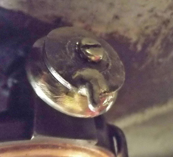

While we're on the subject . . .
Last month I put premium grade gas in the tractor and the next day, my valve went from being so loose I could turn it with one finger against my little knob pointer, to so hard to turn it had me worried.
So as people here said to conclude, I also concluded it was ethanol in the fuel. But the service station assured me there was zero ethanol in their fuel — which may or may not be true I guess.
Anyway . . . I drained the tank and put in what I had been using before that, "Mid Grade" marked gas. Bingo! Two days later the knob was back to feeling normal and actually a little better because it seemed so easy to rotate before, that I half expected it to start leaking one day soon.
So if there is indeed no ethanol in this company's fuel, then there's something about this HyTest fuel (or any Premium fuel maybe) that swelled up the stem seal.

You have your answer as shown by all the replies. I'll just add this from the original '9N INSTRUCTION BOOK': "When tractor is to be idle for 30 days or more, drain the entire fuel system including the gasoline tank. Fuel should be removed through the bottom of carburetor, with Sediment Bulb Valve on "reserve" (means all the way fully open). Gasoline, when stored, forms a gum or wax which has a tendency to clog up the small pores and openings in the carburetor. For the same reason, do not use which has been stored for more than 60 days." The debate on ethanol mucking up these old systems will go on forever, and there is no need to run a Premium grade gasoline in these engines. The exception may be if one has an optional Sherman Hi-Compression aluminum head. As we see by the diagram of the Fuel Sediment Bulb Assembly, there is only one part that is essentially the working, or mechanical device and that is the valve stem. There is a seal and washer in it, and that is the piece that becomes worn and/or torn over use and needs to be replaced as leaking will occur. I've had some newer aftermarket valve stems that used cheap vinyl for the seal that failed out of the box. A new valve stem, p/n APN-9194, sells for about $6 and is much cheaper than buying a whole new sediment bulb assembly. Henry Ford was a frugal man, but with a very limited education. He couldn't read a blueprint, and left the technical side of things to his engineers. His only requirements were to build things as cheap as possible so as to make this products available to the average American consumer. He had certain stipulations, but had nothing to do with technicalities. If you are still a non-believer after all that has been said here, then take coffee can and place it underneath the carb, leave the valve stem open 2 turns, and leave for a few weeks, or a month. Check can every week and then check oil and report back.
FORD TRACTOR SEDIMENT BULB & VALVE STEM :
