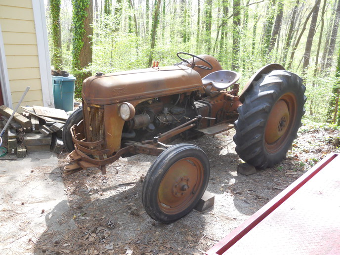

Hi to all, I'm normally at the Case site, but have a new project, which is a nice original 8N, it needs work but love the tractor. I will try and post when in progress for restoration. My question today is what are the best points for this girl, and who supplies them. Any advice I can use. Thanks in advance.

See tips 66, 67 and 68. This site carries Bluestreak. NAPA carries Echlin. Carquest use to carry Wells. Amazon carries all of them.

Side mount distributor so Blue Streak# FD-8081X or Echlin# CS753
Buy them from your local NAPA or other parts store.
You want to verify they have a phenolic rubbing block, not black
or white plastic. The plastic ones will wear very quickly.

I have never seen the plastic rubbing block be a issue on a side mount dist... Never Shocked I have installed hundreds if not thousands never had a issue with the plastic rubbing block across the board...
A front mount is a different animal NO PLASTIC rubbing block...

"I have never seen the plastic rubbing block be a issue on a side mount dist... Never"
You have better luck than I do. I had the embarrassing experience
of a non-starting side mount the day a guy showed up to buy it.
We re-gapped the points, which had a white plastic rubbing block
and were fairly new, then the tractor started and ran well.
I ended up including a new set of quality points and he bought the tractor.
Side mount or front mount, for the difference in price, I'll buy
quality parts when possible and save the frustration.
