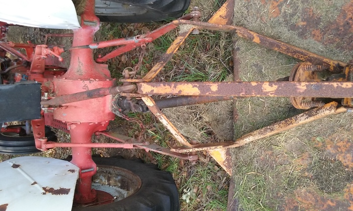

I was curious to know how I can make my brush hog attach in line with my tractor. Attached is a picture of how it sits right now which is offset to the right a bit. What do I need to adjust to accomplish this?

Do not have a tractor like that but looks like you need to shorten your chains up a bit make sure it cannot swing far enough over to hit
rear tire for sure.

Is it with all your implements or just the cutter? If it's all, measure center to center on the eyes on the lift arms, there are fifferent lengths off fifferent machines. If they are the same then you should install a stabilizer bar kit.

I use a sway bar with my 8N and bush hog. A sway bar is a flat bar with two holes, one at each end. One end attaches to the 3 Pt pin at the mower, just slide it on and install the linch pin. The other end attaches under the axle using the fender bolts.
Typically they come in a kit of two bars with brackets which attach to the fender bolts. Just look for Sway Bar kit and you can figure it out. I only use one bar for the bush hog however, some people use both.
I use the bar to hold position however, I have the bush hog shimmed to the right side. I can get closer to the fence with the mower tracking outside the edge of the rear tire.

What's the problem with that? I always pull mine off to the right and pin it that way so I can mow beyond the tire a little. If you would
shorten the chain on the right it would probably center up if that's important to you.

I am new to bush hogging and I assumed it would create more stress for the PTO Shaft to be at an angle like that. Would it be ok to leave as is?

Give the u-joints on the pto shaft a little shot of grease before you start mowing in the morning. It doesn't hurt for the shaft to run offset like that, in fact its actually better for them. If the joints ran straight all the time they are more likely to seize up. I run my mower the same way, it lets you mow a little closer to fences, etc, and it also keeps you tires away from fences, or whatever you are mowing around.

You need a stabilizer bar (sway bar) on each side

Hard to tell from pictures, but check how long the pull bars are. Looks like left one may be longer than right one and pushing bush hog to right. Left on looks longer in picture than right one to me in picture

Since you are new to this, one thing that is very important is to make sure the PTO shaft can telescope freely. As the cutter moves up and down the shaft has to get longer and shorter, if the shaft cannot slide easily with just light pressure the force can and will damage the rear PTO bearing in the tractor. I also do not see an over running coupler, you need to get one otherwise the flywheel effect of the cutter can push the tractor into things (and/or get a good bumper for the front).

Without the sway bars, your mowing will look like a drunk did it. Mower will swing back and forth.
