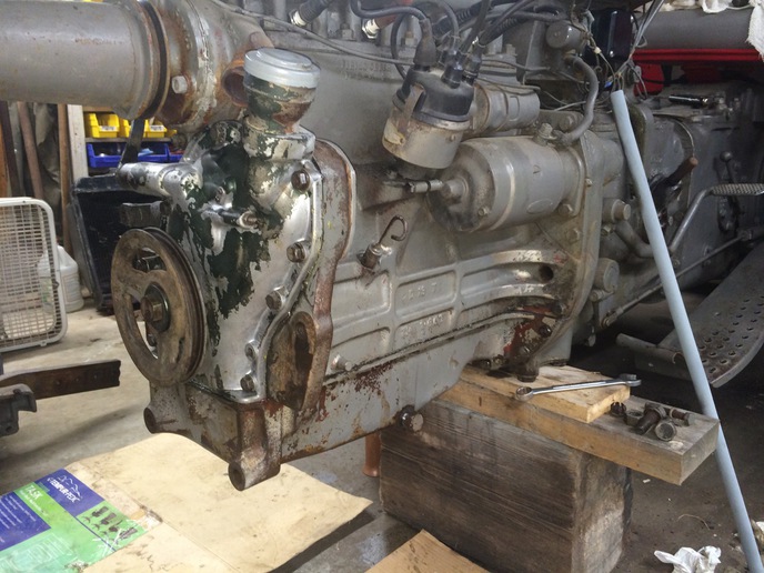

A couple weeks ago I purchased a TO35 and finish mower. Tho advertised as 'everything works as it should', the governor did not. I observed the lever arm 'bouncing' at low speed and there was no function while running. I also observed oil on the floor after a run - thought it was maybe the front seal, but after cleaning things up it looked more like the pan gasket at the front engine cover. Neither a huge deal, I've been into these before and with a rainy day today I hit the shop.
Drained fluids - also pulled the gas tank so I can adjust the valves -
Two hours later, the area of interest is exposed -
The balls in the governor were no longer contained by the cage - dunno - I've seen broken cages, but this is different -
The unpleasant surprise - the front cover has been broken and partially welded, explaining the oil leak -
Here's the trouble items - governor, friction disk/spring, the pulley is rough, don't know if it will clean up acceptably so not to eat the seal - and of course the front cover - I'll do some eBay searching this evening, but if anyone here has one to sell, my email is activated.

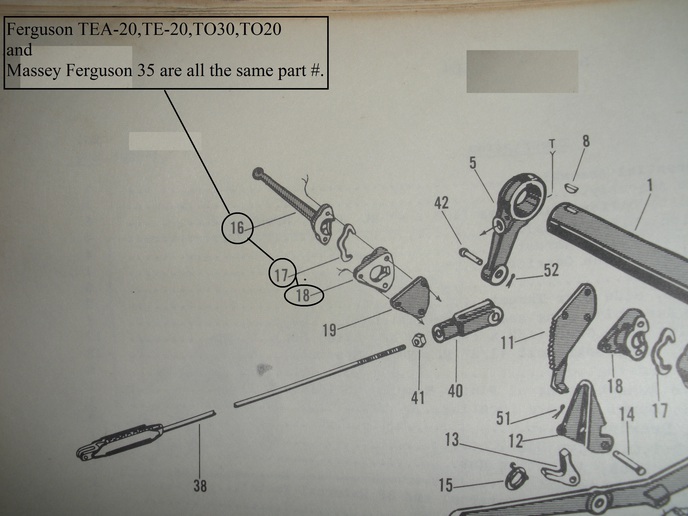

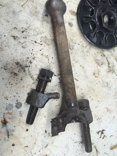

Also looking for a set of foot pegs - one side was broken and the other side cracked - does anyone know if these are the same as the TO20/30?

As per Parts Catalogue:
YES... the FOOT REST / Radius Rod Ball Cap and associated components are the same on the FERGUSON TE-20,TEA-20,TO30,T020 and Massey Ferguson 35.
Owner Operator TEA-20...MF FE 35 X
Bob....

I got most of the parts yesterday and spent the evening reassembling -
The new to me front engine cover is from a 'green belly' - seems OK, the linkage is slightly bent but I can deal with that - I cleaned it up and lubricated the needle bearings - also ran a tap into all the threaded holes in the block and wire brushed the bolts
here's the new governor beside the old, and the cheapest part of this repair, the throttle linkage. I made a new friction disk out of gasket material that's been floating around with me for 40 years and found a $1.19 spring at the hardware that looks to be about right - I think the old governor did not have the proper nut to center the mechanism on the cam gear -
lubed things up and nutted the new governor to the camshaft gear
then installed the governor race -
installed a new seal in the housing and installed it along with the pulley - of course this housing has the earlier style oil cap, same as the TO30 I think, while the housing it replaced had the later style cap, so now I need to stir up a cap - dunno if NAPA will have one or not - they seem rather expensive via eBay -
cleaned the oil pan and associated gasket surfaces, ran a tap thru all the threaded holes, then called it a night - I'm considering running new safety wire thru the main bearing cap bolts - the job that was done at the last rebuild is useless - on the other hand, it's ran for quite a while as it is and it will be a difficult and unpleasant job to do laying on the floor looking up at oil drips... here's the wiring job
and what it should look like (more or less, I'm not well practiced) - this is a Z129 engine I overhauled this last winter
dunno - I'll see how ambitious I feel tomorrow...
