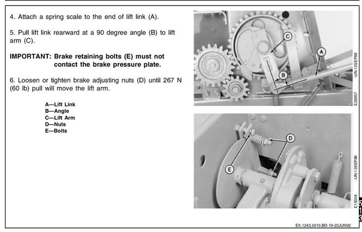

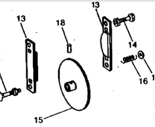

Tx Jim, I just went and looked at a 336 that is waiting to be fixed here. Needle brake is indeed on the left side. Also a 338 that is here.
