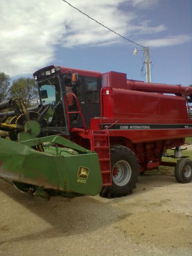

Simple system. I have adapted the JD heads to JI Case combines and Case-IH machines....
