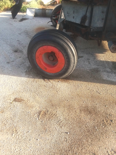

I bought this Gleaner F diesel for parts for $200. It runs very well and drives, but has a flat steer tire. I plan on driving it home about 20-25 miles, but aren't sure if I should just fix the tire or if a complete hub off one of our parts K's will fit on there just to get me home. This F has these huge heavy cast hubs, and I don't know if it'd be easier to find a tire off something else to mount on it or just change the whole hub, it looks pretty heavy.

I had a K2 and F2. I was surprised how many parts were common. They even shared a parts book. Maybe a little searching of part numbers will tell you if the hubs are the same between your two models.

Any standard six bolt implement rim should fit, including the ones on your K.

The F was just one walker wider, all the way through.

Thanks guys, I believe the easiest way to do it is going to be just changing the tire on the combine, since that cast hub doesn't just bolt on, it has the bearings and races in it, not on a separate hub.
