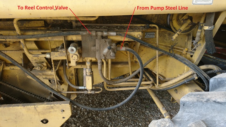

Hello everyone,
I just purchased a double spinner chaff spreader ,used, for my TR98 NH combine. Has anyone ever plumbed one in by themselves?Is it much of a job and do they spread evenly?Can it be driven by the main hydraulic pump back by the engine?I am hesitant to use the reel pump because I am already tapped into it for the bin auger extension.Thanks in advance for any suggestions!!

The majority of them use the reel drive pump because you can vary the speed easily with them. If you try and hook it to the main hydraulic pump you will need a flow valve to control the speed. You also run the risk of making other things not work correctly as the chaff spreader is taking oil flow.

We have a tr98 with a chaff spreader on it.
When we got it was hooked up in series
through the reel pump drive. The problem
with the way they had it hooked up was that
if we were harvesting soybeans and using
the auto reel speed, the spreader would
slow or stop completely if we needed to
back up causing it to possibly plug the
machine. We replumbed it to go through the
spreader before it to the reel speed
control valve, so it runs all the time. We
have a separate flow control valve to
control the speed of the spreader. Had a
tr86 we also had to do this on. We were
going to put a Hydraulic bin auger
extension on it but haven't gotten around
to it yet, but the instructions show going
through it, the spreader and the reel
control valve. Our tr98 has a tr99 bubble
up on it so it is all mechanically driven.

Did you plumb the spreader by using the pressure hose for the reel speed where it plugs in hydraulically on the left side,or the return hose? Sounds like it's pretty easy to make a mistake, plumb it wrong!!Thanks for all the responses!!

I will try to take a picture of it this weekend. It wasn't that complicated. Just a couple of fittings. I will also see if I can find my notes on the fitting sizes.

Here are some pictures of the setup on our TR98. There is a steel line running from the pump to the front of the reel speed control valve. At the end of that line there is a fitting. We took that fitting out of the valve to the local farm store and found the fittings we needed. I believe it is an SAE O-ring size 12 because we couldn't match the flared end for the steel line. So, we went from the steel line back to the spreader control valve and then from the spreader control valve back to the reel control valve.

thanks for the pictures, that's going to help me more than just directions. I found a replacement beater from a company in North Dakota. Great informative!

Just what would be the proper order of hooking a bin fill auger in series with a chaff spreader?All being powered by the reel pump. I want to be sure that I power up hydraulically first what is supposed to be powered up first. Thanks so much for the reply!!

You would want the chaff spreader in front of the reel drive. The way you do it on the JD combines is the chaff spreader runs a set speed. So that demand remains constant. The your reel speed can vary without effect the chaff spreader.
