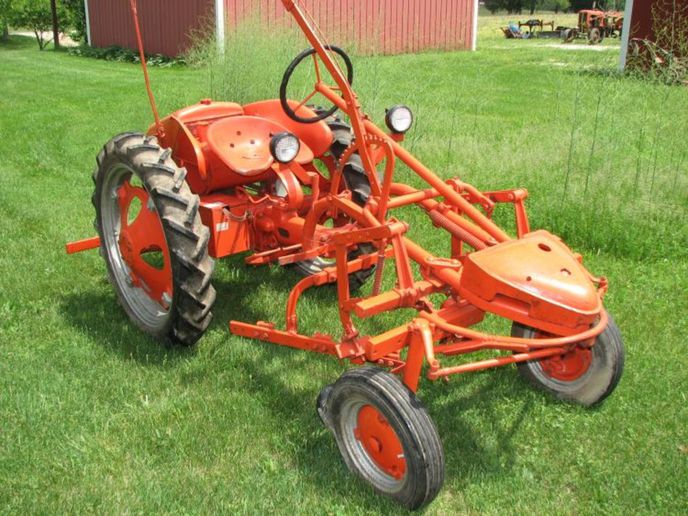

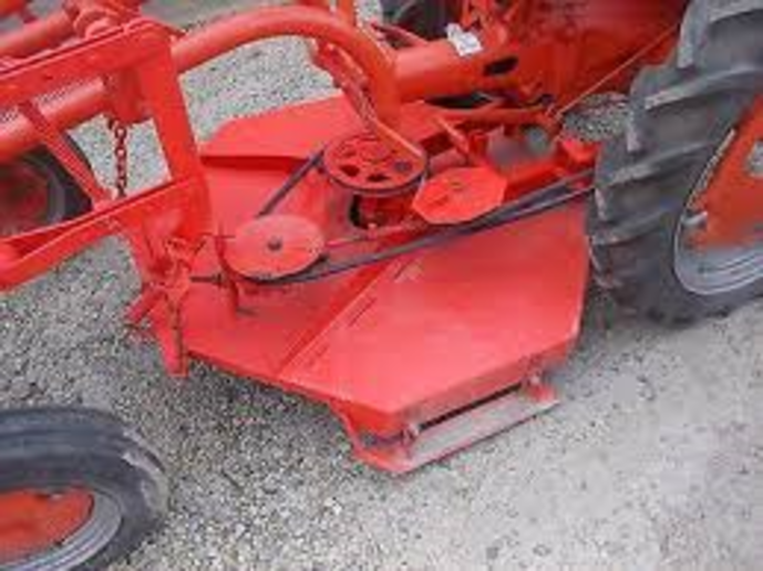

Here are some pictures of different attachments.

Pictures shows one of the Gs with a weight on it.

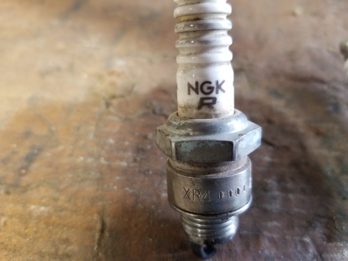

This G Bug has suppression wires on it with a ohm reading around 5-7000 ohms on them. I am wondering if this tractor should have solid copper wires on it. It seems to b running rich and the plugs are a sooty black where #3 is a wet sooty black. Timing has been set to TDC on #1. Plugged are gapped at .030 and points gapped at ,020
This tsx has no hi speed adjustment.. could this be my rich condition?
I just pulled out the plugs and the #3 hole looks wet inside while the others are a dry sooty black
Compression on all the cylinders are an even 90-95 lbs
Air cleaner has been scoured so it's good and clean

Unless it has electronic ignition on it yes the plug wire should be true wire plug wires not the type your saying it has and could well be part of your problem.

That third plug over from the left was not firing so i was loosing 25% power. Put in another old plug i had and wow what a difference. Think now i have 11 horses operating. Tomorrow i get new plugs and solid core plug wires

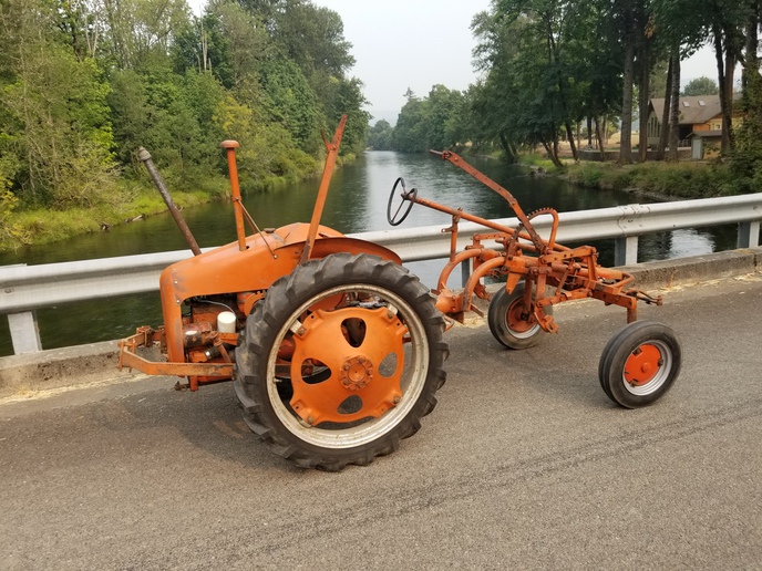

The G Bug on the bridge
Runs great now with copper core plug wires and the right sparkies
