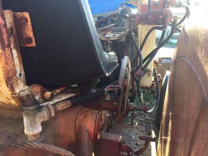

PostPosted: Wed Sep 19, 2018 3:45 am    Post subject: Re: IH 444 - What hydraulic parts are Needed to Install Load Reply to specific post Reply with quote
Thanks for the posting help. I did that last night but it didn't work for me. Slow computer, internet, or brain...
Anyway, this is my 444 as I got it from the previous owner. Right or wrong it works.......
One line comes from the front left of the seat and the other goes to the rear right of the seat.
Hope this helps,
Scotty

PostPosted: Wed Sep 19, 2018 11:16 am    Post subject: Re: IH 444 - What hydraulic parts are Needed to Install Load Reply to specific post Reply with quote
HappyJack, that is the correct way to plumb a loader on the IH models B414, 434, 444 and 384.
JimB

PostPosted: Wed Sep 19, 2018 12:42 pm    Post subject: Re: IH 444 - What hydraulic parts are Needed to Install Load Reply to specific post Reply with quote
HappyJack wrote:
(quoted from post at 00:21:43 09/20/1Cool
CVPost-jimb2 wrote:
(quoted from post at 12:16:19 09/19/1Cool HappyJack, that is the correct way to plumb a loader on the IH models B414, 434, 444 and 384.
JimB
Good to know. I figured the worst case scenario would be someone telling me its wrong and how to fix it.......
Ok. So if that is the correct way, then nothing special is needed? Just plumb the hoses up to the tractor at those locations?

PostPosted: Wed Sep 19, 2018 1:52 pm    Post subject: Re: IH 444 - What hydraulic parts are Needed to Install Load Reply to specific post Reply with quote
RTR wrote:
(quoted from post at 13:42:51 09/19/1Cool
JimB
I believe you need to CUT the metal pressure line and splice hoses on to it...so that is likely the hard part of the job.
