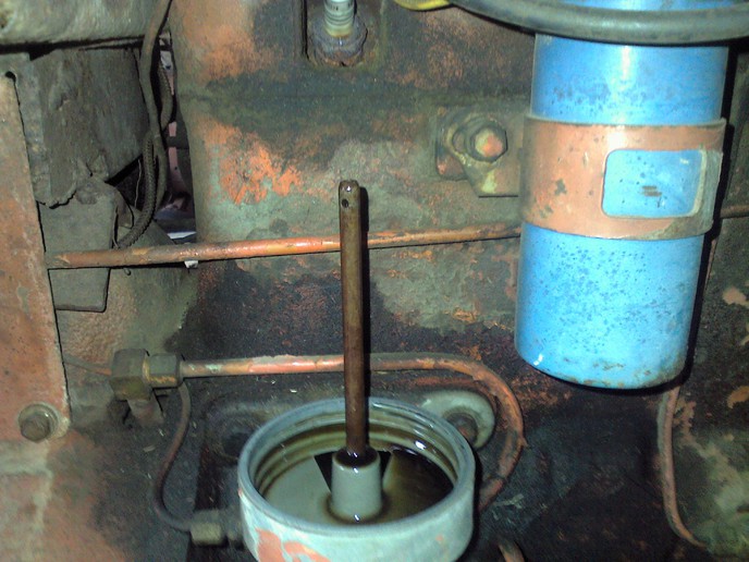

My dad and I have just yesterday got a 1941 Allis Chalmers WC running. When my dad checked the oil pressure gauge however, it read no oil pressure. He thought it was just the old gauge, and put in a new gauge. When we started it again, there was no oil pressure. He could feel it with his thumb when he put it over the hole. Could anyone determine why there is no pressure readable on a gauge, or do WC tractors just have a low PSI?

The pressure at the gauge port is low, did you use the correct gauge for the application? Most regular 80 lb gauges wont read anything. First thing to do is remove the oil filter. There should be a length of tubing that presses in the center of the housing and protrudes into the element, if it is missing the guage will read zero. The gauge will also read zero while a new element is filling. The engine is fine for most uses with very low pressure at the guage, I think the line between low and normal is about 5 lbs?

The WC as with many A/C engines use a oil filter back pressure system that build pressure in the filter. If you put on the wrong type filter or the up right pipe that goes into the filter stayed in the old filter you will have very low oil pressure.

10 to 12 psi is spec numbers. Anything over 5psi would be good enough. That standpipe has to be in there. The filter should be cotton string inside, not paper.

A small amount of water will not effect oil pressure but it can cause major problem with causing damage to the engine if it is very much at all. When ever you change a filter on these tractors you need to be sure the stand pipe stays on the filter housing or you will have not oil pressure

For your reference I have attached a photo of the tube in a D14, which uses the same filter and tube. If missing, the tube is Allis Chalmers part number 70203899.

I'm not sure if I remember, but I think that tube was bent. Does that affect it at all? Also, yes this my other account. I just use the account I initially posted with when i'm at school.

As long as the tube is tight in the base I don't think a slight bend will hurt it. Does it have a slight sweep to it like someone pulled it away from the block when removing the filter? Too much bend might case it to open a bigger path in the media for the oil to run down through. If it was bent enough to crack it or the base so the oil can dump before reaching the upper end of the tube it will be a problem. The tube pulls out it doesn't thread into the base.
The Kleenite filter may be correct if it is packed with fiber, don't have any info on them. Filters that sit on a shelf for years can get dirty if packaging isn't tight and develop rust inside from temperature and humidity changes, so a new filter will be better.
The Wix filter used to be 51011 and worked fine, but a number of years ago they decided to "improve" it by building them with paper media like newer filters. These were a disaster as the engines would not build oil pressure with them. I did an oil change on one of my tractors during that time and experienced the problem first hand. Soon after this was found and they received enough complaints, Wix returned to the packed media and brought out the 57011 to replace the 51011. That is the quick story of why people mention being sure you have the string or other packed media, not paper, in the filter you use.
