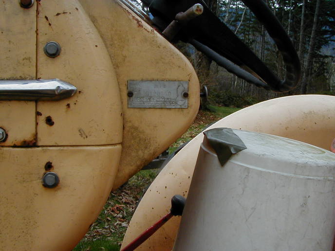

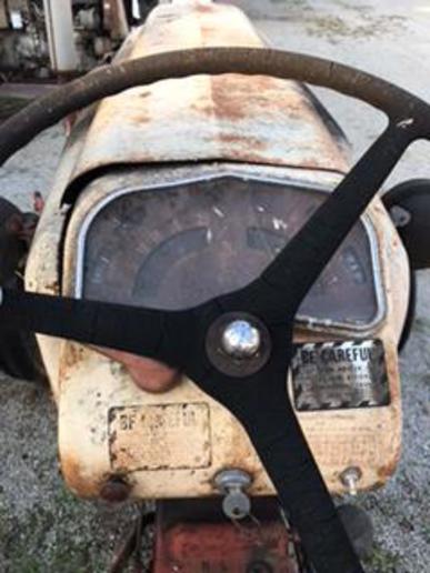

Pic1 Model/serial nr tag location on 300 series round nose tractors and Pic2 on 300B series square nose tractors.

So, here are the pics. Whataya all think? Is it worth $1,000? I'm guessing another $500-$800 to fix her up to respectable, probably $1500-$2000 for a full restoration?
The owners couldn't find a serial # on the tractor. Judging from Joe's earlier picture to me, there seems to be a caution sticker in that spot. I don't know if that's factory, but it sure appears to be!

If it is not a 350, it is a model 311 row crop. You must have missed the down arrow on my tag location pic. Check the area circled on your tractor pic.
This is what you see looking down sitting in the seat, check the hydraulic oil in the torque tube with that dipstick. The transmission dipstick is a 1-1/2 plug aft of the transmission shifter plate under the seat. The notch a few inches above the end of the stick in the full mark.
