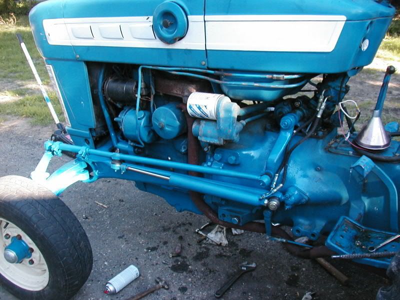

The front wheels on my (newly purchased)3 cyl diesel "72 4000 SU with loader stand out at the bottom - between 10 and 15 degrees from true vertical on both sides. A tractor mechanic here tells me it should have a positive camber (out at the top a tiny bit). The horizontal parts of the knees slant up strongly and the vertical part is cocked way out at the bottom. (The knees align well with the axle where they bolt up.)
Would I be thinking crazy if I figured someone has overloaded it and bent the center axle?
Any other reason likely for the cocked wheels? Wrong center axle? Wrong knees?

First thing I'd check is the bolts fastening the knees to the center section. partially sheared and holes chosen too close together will make it sag. Set the axle narrow, place the bolts as far apart as possible.

Thanks. I don"t have it here to check how close the bolts are, but the knees do line up edge to edge with the center piece.

here's a front shot of my 68 3000 diesel.. it has the same 'light duty' front end of a 4000 SU
look similar?

Thanks for the picture; I'm glad to have something to show what mine is really supposed to look like.
Similar indeed. Of course there are differences. Mine has power steering and other differences. But the obvious thing is in my description of the knee positions. I see a slight slant up/out in the picture. As I indicated, mine are slanted much more, causing the wheels to sit at an angle cocked out at the bottom. It looks like it's squatting ready to do something smelly.
The center and the knees are aligned the same - edge to edge. But the center is obviously bent up to the outsides compared to the picture.
I foresee a problem figuring out what angle to correct the bent part to once I get the loader off and the dis-assembly done. But I guess one can hang/prop the knee/wheel assembly with the wheels vertical and measure the angle of the horizontal part of the knee.

might be easier to get a non bent center axle section.
soundguy
perhaps one of these.. or simply a junkyard or salvage part better than yours..
Support Front Axle - Front axle center support. For Models: 2000, 2100, 2110, 230A, 231, 234, 2600, 2610, 2910, 3000, 3100, 333, 334, 335, 3600, 3900, 3910, 4100, 4110, 4140, 4600SU, 530A, 531. (Part No: C7NN3010F) $119.90
Support Front Axle - Front axle support. For Models: (2000, 3000 1965 to 71970), 4110, 4140. (Part No: C5NN3010D) $218.91

yep.. if they cock out at the bottom, I bet that center axle is trashed.
does it look welded on or modified?
