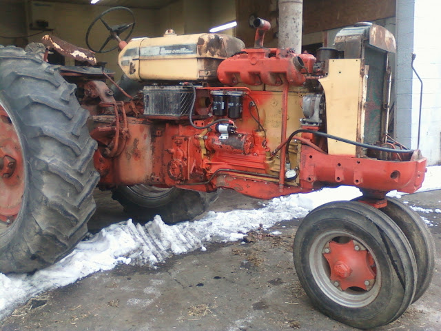

Here is a link to pics of our winter project. Installing a 336 turbo in a low tin 830 Case-o-matic. Tomorrow it is off to the paint shop.
Enjoy!
https://picasaweb.google.com/JHH1346/830COM?authkey=Gv1sRgCI_Gtq3vqJD3gAE&feat=directlink
We almost got it all under the hood.

Nice! How many parts are off the WI engine? Where are you guys going to put the battery?

We put a 970 air cleaner on the left side of the battery tray and the battery lengthwise on the right side. Had to let it stick out the right side about 1 1/2". Have to loosen the clamps on the air filter inlet and outlet and slide the tray out to change the air filter.

Agri King, Sorry I missed your first question.
We only had a 336 short block, sleeves, pistons, crank, and cam. Starter and flywheel came from the 830. All other parts except the exhaust manifold and turbo came from the WI engine.

how much room between the hot side of the turbo and your hood? Did you install a heat shield on the hood?
Where do you get the oil supply to the turbo from? I see your return.

Where did you find the exhaust manifold?

Bought new manifold but had to make the adapter between manifold and turbo they are no longer available. Also we had to make adapter shorter and tilt it toward the center so it would fit under the hood. Have since found a couple of used manifolds with the adapters, if anyone needs one.
