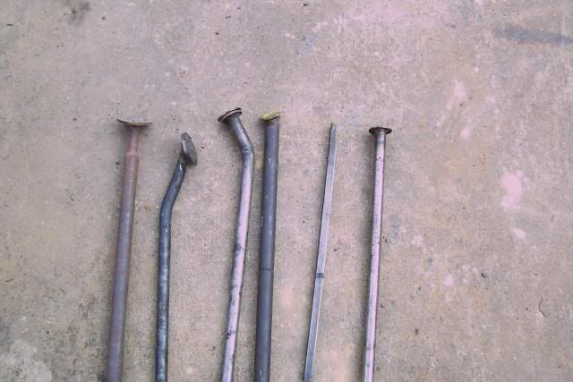

PostPosted: Sun Jun 05, 2011 4:55 pm    Post subject: Re: Freeze plug help needed Reply to specific post Reply with quote
How I would do it,,, cuzz someone else is ask'n over on the N board... I would make a rod, bend grind are what was needed to get a good shot at driving a new plug in,,, you will need to weld a flat washer to the end of the rod ,, the washer needs to fit inside the freeze plug,,, i prefer a deep well plug even if i have to grind part of it to clear the obstruction,, You do not have to get a straight shot at it,, work from both sides and walk it in are stop and tap the edge to align it Wink I like permatex aviation gasket eliminator to seal it...
[url]
This one has been modified dozens of times..
[url]
[img]
part of my collection that has served me will
