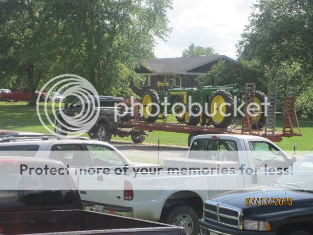

I have a gooseneck that has three ramps that lay flat on the dove tail. I am wanting a way to hold them all vertical. Anybody have any pics or ideas?

You could put a pipe or bar between them to kind of pin the center ramp to the outer ones, then mount some flat bars or angle irons on each side to pin the end ramps at whatever angle you want. Putting the bars or angles on the sides would allow them to lay down out of the way when loading and unloading.

This is my trailer ramps made like Adrian posted suggested. It works pretty good.

I pin the middle ramp to the dove tail with the outside ramps pin to the mid ramp

The new PJ pins just like the outside ramps with its own bar.When you lower the middle ramp you can take the bar that holds it up completely off.
