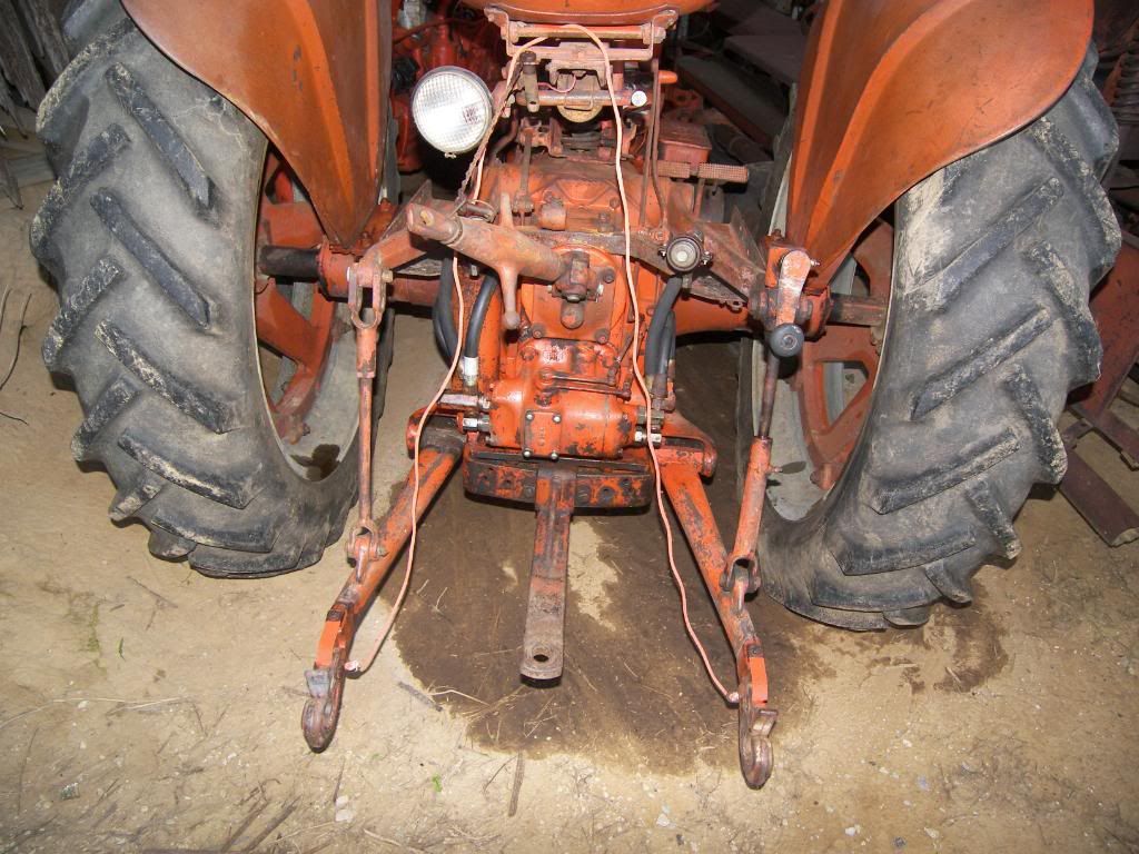

This will be easy for someone and probably funny, does 3pt implements work with the eagle hitch? looks like they would.

Most 3 point cat 1 implements will work or can be made to work on the eagle hitch.The more worn your eagle hitch is the easier it is to hook up.

Here's a picture of the back of my SC showing the toplink and brackets we talked about.

I'm not sure. I have a 210B and the blade attachment I have I had to modify a little because it was too wide to fit the hitch. The arms on the eagle hitch are not as adjustable in width as other hitches.

Thanks everyone for the info. sounds like it will work but sometime it may take alittle modification, thanks for the pictures Nick you have alot of nice stuff. Mike

Mike, sometimes the only modification needed is to turn the draft arm lift pins to the inside or outside depending on how the implement is configured. Also the eagle hitsh pins on Case equipment had a round head on the ends to keep the pin engaged inthe hitch, on conv. 3pt equipment it would be a lynch pin on the end of the hitch pin. I haven't seen too many 3 pt implements that wouldn'y directly hook up or maybe just a pin change.
I have a Danuser blade that I made hitch boxes for rather that just use a bolt and 2 nuts but that was just my wanting a stronger hitch point.
