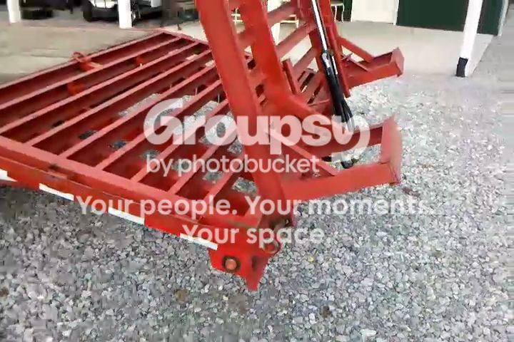

This Coyote trailer, made in Ohio, I ordered this spring works great for me!

Does the manufacture of the trailer your looking at offer a third ramp? I have the three ramps on my trailer and they are heavier than the landscape ramp also they can be moved and have spring assit.You can also get the ramps that stand up or the ones that fold over and lay on the beaver tail.

I have a 3ft. beaver with three spring assit 5 ft. standup ramps. My trailer is a 14,00o lb. PJ bumper pull 24ft. long,102 inchs wide and is a low profile. The rear of my trailer looks a lot the rear on the picture of mister Hecks trailer. only differance is that mine has the three stand up ramps.

So far no problems loading/unloading at all. This set-up works great for me! They have 2 heavy assist springs on each gate. Tractors I haul range from 3500 lbs. to 8000 lbs.
