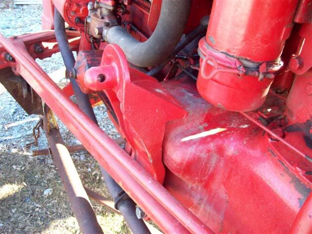

Looking for pictures of a Ford one armed loader. Neighbor had one when I was a kid. Trying to remember how it was mounted. Anyone that has a picture of one, I would greatly appreciate seeing it.

Here's the mounts on my 641

i have quite a few of the 711 and 722 loaders. they were for 8n up thru the small 3 cyl series, including some fordsons.
here's one of my 850 with a 711, some pics of the brackets and other various brackets used.. and another 711 on my 951 rowcrop.. it has a trip bucket.. the one on my 850 is a full hydbucket..e tc.

This is mounts for my RC 901. The one for the 8n was totally different and are hard to find.

On your 711 with the manure bucket did you fab up the side pieces or did it come with it. I have to make a set for my manure bucket. Can I see a close up of how it's attached, when you get the chance.
Thanks, Kirk

yes.. those are added on side plates.
I have a couple examples of maneuer buckets.. some are plain.. some hav ethe material plate on the tines, and some have added on side plates.
i'll try to get better pics this week.

I have the bottom plate on the tines on mine but don't have the side plates. Anytime you get the chance, no rush, to snap some photos of the side panels.

Here is my 8N with 711 loader with manure forks and dirt plate installed.

I have heard that they are very good, but to look at them , it looks like if it were to be full, the weight wouldn't be distributed evenly, especially on a tricycle . you would almost think it would tip over. Just my thoughts .

I can lift the right rear tire off the ground with a too heavy load on the bucket.

They're rated for 1000 lift and they recommen 1000 lb counter weight with an additional 400 lbs on the right side.
Adjusting your wheel out and adding weight to the right rear might help but you probably have owned your loader a lot longer than I have mine so you probably know its limitations.
