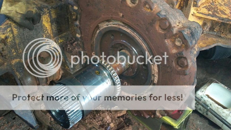

Our TD 20 C has a drive out pin and the manual says to position the pin foward 6" of the front upper idler.
To get grease in we just about always have to press the old grease out and start pumping with 90wt or hytran (something thinner we have on hand), we made a fitting for the pneumatic pump on our cherry picker, then we can start in with the electric grease gun.
Current state of our dresser:

PostPosted: Fri Mar 15, 2013 4:00 pm    Post subject: Re: Dresser TD7 G track adjuster Reply to specific post Reply with quote
Have you found your final drive cover.. Should have several laying around. jm

PostPosted: Fri Mar 15, 2013 8:56 pm    Post subject: Re: Dresser TD7 G track adjuster Reply to specific post Reply with quote
jm. wrote:
(quoted from post at 19:00:28 03/15/13) Have you found your final drive cover.. Should have several laying around. jm
We found a new part for ~$1600. Havent pulled the trigger, what do you have and how bad will shipping be. Unloading is not a problem.
