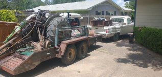

Hello,
Here is my old Ford. It makes 1,200 mile round trips between Texas and New Mexico. Not crazy about the 4.10 and non overdrive 4 speed on the freeway but it does the job getting a load moving. Crossing the desert these last three summers has me wondering why I still have all the parts to add air conditioning sitting on the shelf. I may get around to it some day. Depending on how heavy the load the 352 gets between 6.7 to 11 mpg at 65 mph. Haven't ran through a full tank in several years without pulling a trailer at some point.
Thank's for looking

hank's for the complements. The air cleaner assembly is off a 1974 440 Dodge motorhome I hauled off. Those hoses are the air conditioning ducts from it. I kept the Thermoquad off the 440 but am running a 1977 Quadrajet at the moment.
I also have done away with the deadhead pressure regulator and filter rigged up on the front of the left head. Now it has M6676 Carter and 3/8" fuel lines. The LMC gas tank had a restriction at the flair so I had the gas tank opened up to 7/16" outlet. The Carter pump is for a F-600 with a 391. It has 3/8" in/out and a screw on filter.

Finally got around to swapping the FE for a 1965 430 MEL. With the taller 1959 MEL intake the MOPAR air cleaner sits ½" below the cab lip. It was all nice clean and black for a while. The blue water pump is an OEM core I rebuilt. The new unused aftermarket pump started leaking right after it's first installation.

As reference to the MEL size, The FE had a 1" adapter and a 1" spacer under the Quadrajet. The 65 Lincoln Carter has the factory 65 5/16" spacer on top of a taller 1959 (58-60) 4 barrel intake.

Just completed my last load moving back to Texas. Around trip 25 to 27 for the truck and 5th for the 430 MEL. Running all stock 1965 Lincoln 430 it gets 10.5 mpg empty (4800lbs) with a 3.73 Dana 70 and without overdrive. This last load was probably the heaviest I have pulled with this engine. The trailer weighs 3400lbs empty. Loaded with the 6 cylinder Funk, Sherman Power Digger, Blackhawk dozer blade, home made dump trailer and around 1200lbs of household and shop goodies the old truck got an average of 7.7 mpg @ 65mph.
EDIT: False, I forgot to mention the 65 MEL modifications. 1974 Dodge 440 air cleaner, taller 1958-59 MEL intake manifold and 1958-1960 Edsel exhaust manifolds. Springs are weak from years of hauling a welder. Had some new $1,6XX springs made up for this last load. When I installed them they turned out to lower the truck 1¼", so went back with the originals. For now anyway. I'll post when I find a shop that has the original specs.

The digger arms patchwork broke last time I used the hoe. Spent $16 today pressure washing the gunk off. I spent 30 hours or so with the dozer blade recutting a couple of properties flooded in the 2024 flood in Roswell, N.M. Some front wheel weights would have been nice to have.
