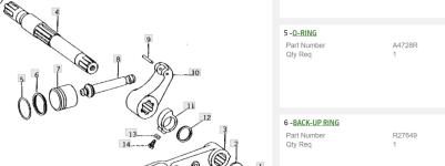

Well, a few months and some hours on the tractor later, I’m starting to see more hydraulic problems. I rechecked my pressure, and I’ll get 2100 to the six hydraulics at idle, and 2000psi at 2000 engine RPMs.
I tried adjusting the pressure on the pump, and it appears that I have the older style flat blade screwdriver adjustment, and that is maxed out as tight as I can get it.
The new issues developed are this: if I’m operating the loader with a heavy 3 point implement, the implement will drop 2-3 inches or so with the lack of pressure. Then when I stop operating the loader, the 3 point comes back up.
Additionally, if I have the tractor running, in park, and I steer the wheel to the left, the wheels will stop and I’ll lose all hydraulic power and I can hear the pump change tone. No pressure to SCV, loader or 3 point until I turn the steering wheel back to the right. Then everything comes back as normal. It doesn’t do this while the tractor is moving.
I have a good feeling my rock shaft pistons seals are leaking because if I have any weight on the 3 point, they’ll slowly drop immediately after shutting the tractor off. Would leaking piston seals cause all this? That’s a pretty big job for the middle of hay season, but I don’t want to keep going if something is on the verge of failure and risk doing more damage.

The three point hitch should stay up with a load on it . Even with the engine shut down .
It appears that the three point hitch is demanding oil when it should not be . Piston seals , relief valve or control valve .
I agree it sounds as if rockshaft piston seals are leaking. That is one of the easier hyd repairs to perform. With 3 pt lowered remove rockshaft piston cover then remove piston. Replace piston seal the replace removed parts. Part #s required are in the photos below.

will a leaking piston seal cause constant hydraulic draw even with the 3 point all the way lowered?
from what i'm seeing I need the seal and backup ring (#5 and 6) in the second diagram. will i need #9 from the first diagram as well? Looks like some sort of gasket or o ring.
