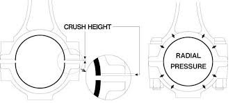

When the bearing shell "CRUSH" would no longer exist, on a 4000 HP Nordberg 4 stroke engine,(Pictures)and the Crank pin Journal was damaged ,I had the specific JOURNAL ground down undersized up to a maximum of 10% undersized.The Bearing shells were custom made by WASHINGTON IRON WORKS of SHERMAN TEXAS USA.
I'm not one to argue if the terminology is "UNDERSIZED BEARING SHELL" or "OVERSIZED BEARING SHELL". However,if anyone has ever sat the Stationary Engineers EXAMS,and or DIESEL ENGINE EXAMS...the answer is usually "UNDERSIZED SHELL"
