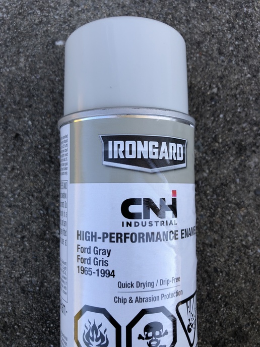

I'm restoring a 6000 pedal tractor for a friend of mine. I went to our local Ford dealer to buy paint this morning and he tells me there are 3 different colors of white. This pedal was only made in 1965-66-67. What would be the correct color of White that was used on farm tractors of the 1965-67 era. I don't want to guess & I sure don't want to paint it & find out I used the wrong color. Thanks Gerald
This is what you want. It goes on with a slight brown-yellow tint, but dries to an off white.
It s actually called Ford gray
Don t know what year they started using it but all 65/94 models used Ford Gray that looked like a off white, has a bit of a tannish look when first applied until it dries
The Ford blue was used 63/99
94/later NH tractors used white
99/later NH blue has a purplish look

FORD INDUSTRIAL PAINT:
Ford Tractor Blue (1962)------------------------------12720
Ford Tractor Blue (1963-1965) - M20J1639A-------------12809
More Ford Tractor Paint codes
Ford Beige--------------------------------------------33186
Ford Gray---------------------------------------------30570
Ford Gray---------------------------------------------32663
Ford Gray (1948 & 1954)-------------------------------32675
Ford Yellow-------------------------------------------82536
Ford Light Yellow-------------------------------------82549
Ford Red----------------------------------------------2833
Ford Red (1947)---------------------------------------70075
Ford Light Red----------------------------------------72598
Ford Equipment Dark Blue------------------------------12908
Ford New Tractor Red----------------------------------71969
Ford New Tractor Silver-------------------------------33442
Ford Tractor Buff-------------------------------------81339
Ford Tractor Gray-------------------------------------30448
Ford Tractor Gray (1965) - M20J1750-A-----------------32571
Ford Tractor Gray (1965)------------------------------32571
Ford Tractor Green------------------------------------42940
Ford Tractor Yellow (20J3132A)------------------------82179
Ford Tractor Yellow (New) (M2J5394-A)-----------------82291
Ford Tractor Orange Red-------------------------------71346
Ford Tractor Vermillion (1949)------------------------3155
Ford Tractor Vermillion-------------------------------70205
Ford Tractor White------------------------------------8712
Ford Tractor & Implement Buff #1640 (1967)------------22914
Ford Tractor & Implement Buff (1967)------------------4068
Ford Tractor & Implement Buff (1967)------------------4119
