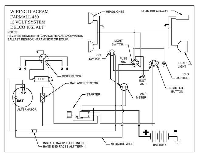

My temp and ammeter gauges weren't working on a newly acquired 1958 350 utility tractor that was operating perfectly. I replaced the temp gauge/sending unit with no problem, but there were no wires running to the ammeter. It was obvious that the tractor had been converted to 12 volts at some point in time. I removed the controls panel and found that the start button had a wire from the solenoid on one terminal as expected, but had three wires on the other terminal. One wire was from the ignition switch, another wire was from the solenoid battery post, and the final wire was from the alternator BAT post. I tried wiring in the ammeter according to diagrams I found on the internet with no success! It looks like the problem is with the ignition switch which looks to be the original switch. Does anyone have a wiring diagram based on the original ignition switch?
The diagram I have attached is how your wiring should
be connecting. However, to be correct the wire for the
solenoid push button connecting to left side of the
ammeter SHOULD connect to the right side of the
ignition switch to keep the starter from engaging if the
ignition is not on. If you have a one wire alternator
disregard the connections to the two alternator side
terminals labeled 1 and 2.

Not sure what you have going on there, you have to wire it per the diagram. I am guessing you have connected wires to the side of the ignition switch that is always powered that should be on the side of the switch that turns on and off with the ignition. You should have one wire connecting to the ignition switch from the ammeter that always has power. Then on the opposite terminal of the switch you should have 1. a wire going to the ignition to power the coil, 2. A wire powering the start button, 3 a wire going to the charge light. The charge light socket should have a second wire that connects to the wire running to the number 1 side terminal of the alternator, in others words that charge lamp connects in a series. Did this ..ignition on.. light go out once the engine started and the alternator was charging? Sometimes the terminal 1 of these 3 wire alternators are wired using an ..Accessory.. terminal of a key switch. Is this what you had? If so the added lamp had no purpose and must have just always stayed lit. It would also be wise to make sure the coil terminated showing negative or minus is running to the distributor.
Edit: Sorry, I have a couple different diagrams I post depending on the type of start system you have. This is the one that shows a start solenoid. I forget this one shows a diode in the wiring to terminal 1 on the alternator. The dash charge lamp goes in there connected in a series replacing the diode.

k, I don't have a charge light, so there must be a diode somewhere because I have power to the coil. When the ammeter was bypassed the ignition light went out when the engine started. I don't see a wire on your diagram from the ignition switch that powers the start button, i.e. your #2?
You've given me enough info, so I can check all wires to make sure they're per your diagram. I suspect the problem is with the ignition wires or the start button wires.

orry about missing your start button power input wire instruction in your first reply! Connecting the wire you identified is the only way I've been able to get the start button to work, so now things are starting to make sense. I'm in the process of making your wire checklist.

Used Red, you did it! Everything works as it should, but it won't shut off when you turn the key to off. So, all I have to do is put a diode in the #1 wire from the alternator is that correct??
You did it! Everything worked as it should, but the tractor wouldn't shut off when I turned the key off. Now all I have to do is put a diode in the alternator #1 wire, is that correct??
Here's one for a 450. Should be near the same
(quoted from post at 16:58:24 11/13/23) Here's one for a 450. Should be near the same
<img src=https://www.yesterdaystractors.com/cvphotos/cvphoto166644.jpg>
hanks, I'll take a look at it!
Here is a diagram for an H or M. Look at the circuit
feeding the ..1.. terminal. It has the light in a series just
as I suggested yours should be. You do not need a
diode if the light bulb is the proper resistance which it
must be if it shut off before and charged the battery.
Let me state it a little differently. What you are
experiencing now is the charge voltage of the
alternator continuing to power the coil. If the light is in
the terminal 1 or excite circuit the filament of the bulb
cannot carry enough amperage to operate the coil. So
when you shut of the ignition power and the alternator
tries to power the coil the light bulb lights up and the
engine dies because as I just said the connection back
to the coil through the filament cannot support spark
because the voltage to the coil drops to low. Make
sense? Sorry if it does not. To me it as just as clear and
