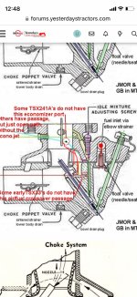

Go to throttle it up, and it begins to misfire, the faster and faster the worse it gets starving for gas, for giggles I spun the main jet out completely, tractor runs amazing from idle to wide open throttle. Well whatever I'll just plug the hole and see what happens, tractor leans out again. (What I should have done is drilled a tiny hole in the top of the carb and called it a day haha)
So I pull apart these two carbs and I cannot figure out what is really different about how they keep the pressure in the bowl at atmospheric pressure
I look the shafts and all the important parts the old one needed out of the new one and slapped it together
Tractor starts right up and idles fantastic
But now when I throttle it up it's running like the choke is on, not much but some black smoke and it will do this right up until the main jet and the idle mixture screw are shut off (the screen on the air cleaner is clean, oil bath cleaned and oil replaced) and even does this with the intake tube removed
