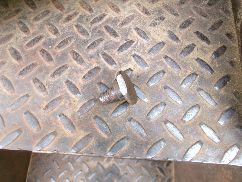

BTW......................... When I changed out the blades, one of the pockets was ruined. The blade bolts are like carriage bolts............fit in a slot to keep them from turning when tightened. Pretty much like the bolts that hold the sickle guards on my Hesston. I made a tool for the Hesston that holds them in place when tightening.
Anyways.......................I'm about 50mi from the nearest Krone dealer, so I wasn't gonna go running off for a new bolt. Besides........it's the pocket in the turtle that was damaged.
Grinding a coupla flats on the blade bolt will allow you to hold it with an open end wrench. Make sure to orient the flats so that the bulk of the head is to the rear. This allows for enough meat to counter wear when the blade is moving. While it's not written in stone, I ground the flats to fit a 27mm wrench. I hate metric, but when in Rome................................
The machine work on the NH650 baler was all metric...........you gotta just figure a thou is a thou is a thou. Just numbers.
27mm is almost a perfect 1-1/16" if that makes you feel any better. Only a few tenths, that's .0004" difference.
Metric isn't so bad once you figure out that over half the sizes cross over. Last time Harbor Freight had a free tool offer, I got the Metric wrench set, and all I've used it on so far are SAE bolts. I choose the metric set because the 10mm is one of the few there's no SAE equivalent for.

Hey...............before I forget about it.
The winch is only for transport. The original hydraulic cylinder setup is used for raising/lowering in the field.
