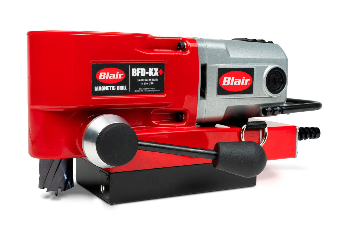

A picture of "Old Faithful" and associated cutters. New in about 1998. I've drilled a lot of holes with it, in weather that would make the Postman blush....
