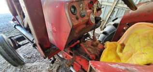

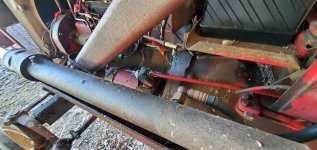

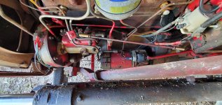

Hello I'm new here. I'm a 62yo lady trying to keep things running since my husband passed. He taught me a lot so I'm not afraid to get my hands dirty.
I have a 1962 B414 diesel with the lever start and it's getting really hard to start Sometimes i mash the lever all the way down and it does nothing. Sometimes it does start but I have to mash the lever all the way down and it didn't used to be that way.
I've read a lot on here and I can tell you guys are knowledgeable. I don't know if it's original or been converted to a starter with a solenoid. I'm attaching some pics, hopefully someone can point me in the right direction. It has a new battery. I don't know if it needs a starter or not.
thank you in advance!

Hello kertel77, welcome to YT! Your starter may just need the switch the starter the mechanical lever connects to replaced. There may be more tricks to it. But for right now I would suggest you go in your first post that is duplicate and use the Edit button and take out all the wording in there including the title and just leave an Oops in there may have to be in both the title area and the subject section. I think you can take the pictures out as well on a PC. To edit on a phone click the 3 dots to the right of Report at the bottom left. If you do this it will cut down on confusion when answers are given in 2 different places.

Just glancing at your photo before I missed that the configuration you have is different from how I originally thought it was equipped. However, my comment still applies.
Messicks IH B414 parts catalog In this link(underlined) go to Category 06 Electrical, Diagram 068 Cranking Motor. This is that companies “modified” manufactures (Fiat/CNHI/CaseIH) parts catalog. Look at key 2 where it shows a picture. Not showing a cart at the lower right of the frame indicates it is no longer available from the manufacturer. (As opposed to part 3 the rubber cover, wow look at the price on that!)
The part number in red 81712538 below the picture is a superseded (updated) PN from the original number. A search for the number above shows it as available from the parent company of these forums All States Ag Parts, see link. ASAP part
I could explain a test process to assure that this is for sure the problem. It would require a 12 volt automotive test light or a multimeter; and to do it safely a 2nd person.
You may be able to loosen the 4 screws and move the switch towards the lever so that it engages better. But you should get an owners manual that should explain it better. You don't want the starter pinion spinning before it is engaged with the flywheel gear.

Here is trouble shooting the starter method BUT MAKE SURE TRACTOR IS IN NEUTRAL, PARKING BRAKE ON AND WHEELS CHOCKED AND STOP KNOB HELD IN STOP POSITION with vise grips on the rod.
1) Do not push the starter lever down, take a screwdriver and for 5 seconds short the the connectors together on the switch on top of the starter in front of the rubber boot by the starter lever, the starter should spin but not engage into the flywheel and not turn the engine over, repeat a few times to check that the starter spins each time.
2) Push the starter lever down, take a screwdriver and for 15 seconds short the the connectors together on the switch on top of the starter in front of the rubber boot by the starter lever, the starter should spin and will be engaged into the flywheel and turn the engine over, repeat a few times to check that the starter spins the engine over everytime.
This will indicate, if the problem is that the switch on top of the starter is not engaging or if the starter solenoid is failing or if the starter motor could be a problem.

Hi 3,000 hrs is nothing on those tractors unless the Hour meter has rolled over 10,000 and it is really 13,000 Hrs but it looks in good shape so probably 3,000 Hrs.
Most likely problem is the Switch in the photo below with the RED arrow pointing to it. Make sure the switch mounting bracket is standing straight up on the starter, not bent forwards and leaning to the front of the starter. The switch part number is 705383R91 which is a common switch used as a clutch neutral safety switch in the newer tractors.

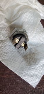

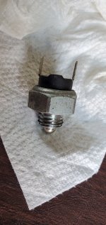

sorry it was a crazy work week and i'm just getting back to this. I pulled that switch off and followed Used red MN links. Messicks says it's discontinued. ASAP parts has it if I follow his link but it doesn't say it fits a B414 but it's similar. I wish I knew how to reply to both of you at the same time.
my switch pics

I believe that ASAP parts are saying it doesn’t fit B414D because the B414 never had a clutch neutral safety switch, the safety switch was not required until later models like 444 and 384 tractors.
According to the part number from my very old B414 parts manual it cross references to 81712538 number.
But on your B414 that switch is used in the starter to engage the starter solenoid that is mounted on the firewall in front of the battery box.
ok thank you. it's mounted on the starter, not on the firewall. like your pic. The lever starter arm engages it directly. I went ahead and ordered one. I'm going to super clean all the contacts and wait for the part. I'm sure it's the original lucas starter. It's still a positive ground and I don't see where it's been converted to a solenoid starter.

I confused you on my last post, the switch you are going to replace energies the starter solenoid on the firewall that supplies the battery voltage to the starter.
