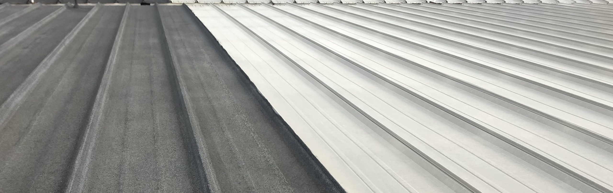

Using Urethane based archetectural grade caulk from Sika or other pro (not big box) brands under the laps that leak then using exterior gasketed screws to tighten those joints would be appropriate. There does not look like much heavy rust. Jim
I have a thread going over in Tractor Tales where I tried this process (albeit with a different roofing cement/caulk) on a test section of roof at our place.
It's leaking.
But... the roof in this thread appears to be much simpler (less chance for flashing issues) and in better overall condition.
What I (or any of us) can't see is the condition of the underlayment/barnboards/purlins/old shingle roof.... whatever is underneath. If that doesn't hold a screw, re-screwing is... screwed.

Late to the party, but will confirm a corrugated sheet will bend that roof at a full length sheet. Back in 77 Pa was told the 8” pro rib would perform that task. Ma was excited and wanted white. That made Pa excited. It didn’t. It kinked the ribs. Ma was sad. That made Pa mad.
So a week later a load of 2” rib galvanized 24ga showed up and was installed. They didn’t offer colored steel outside of pro rib at the time. That roof is still on today.
Talk to a supplier there are rib options out there. 3/4”, 1”, 2”.
Take your time and find an Amish crew to put new steel on it. With you living in Ohio they are available and reliable. Also google "Barn Preservation Ohio" This will also give you some leads.
