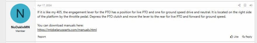

In one of the other posts about another Belarus model... this answer was given.
Does your Belarus have this setup; where it can either fluctuate with ground speed or engine speed?
