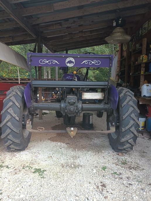

I have been using a woods 72 inch belly mower on my
farmall B for years. I mow everything from lawn to
roadsides of tall grass
