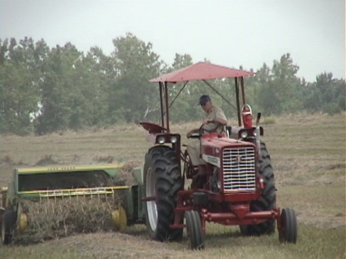

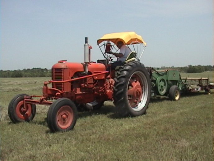

For example, attached are pics of two of the tractors that I have hauled to Kansas and back. Not both at once but different years. For an example of managing the converter's lockup clutch, it was 99 degrees when I hauled the 7500 lb 656hydro 3 miles up the long grade just east of the Mississippi river NE of Hannibal.
Managing this occasion called for first checking for Smokey the Bear and then easing up to 75mph in 3rd lockup on the flat. Then stay about half power on the gas in order to keep the converter locked up as the speed slows to about 50 mph on the grade. Pulling the tranny into 2nd at 50 mph with a little gas applied is very smooth and the engine only goes to about 3500 rpm. My tranny will lock up in 2nd by a quick back-off of the gas. I can hold 50 mph in 2nd lockup on this grade. The engine and tranny are happy doing this. Okay, so I have lost a quarter mile to any "pedal to the medal guy" on the grade.
Except for going thru towns, I manage to run 99.9% of the time with the converter locked up and the tranny stays "cool". Who cares you say!! I understand. lol
