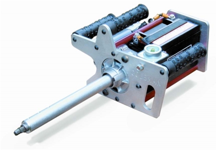

I use a gokart starter for my generator and gas powered air compressor.

On a lower post I sent a picture of a gokart starter. More info on that: Pros: 1)Can be used for multiple engines. 2)Starts from the flywheel nut which you can put a socket on the end depending on the size of nut. 3) will start high compression engines. 4)One battery to maintain and can be used for at least 50 starts. 5) It has 2 side handles to hold device so the torque turn will not snap at your wrist as a power driver will.
I've used mine on 9HP engines with no problem. I used to be a starter at a go kart club track and probably started 75 engines on a given race day. These engines were highly modified with very high compression!
Con: They are about $250 new. They can be found on ebay used for about 150. If you were close to me, I would let you try one of mine out. I have 2 of them and use them both.
