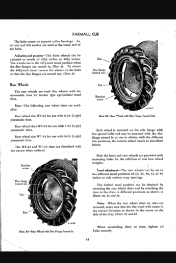

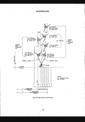

You may not need to swap the tires from one side to the other.
What width is your tread set for? At some settings, you can turn each individual tire around and reinstall leaving the tread the same. At other settings, turning the tires around will require changing the tread by 4 inches.
I understand what you're saying now. I don't think simply turnng the tire around will solve the problem. The square ends for the bolt heads would be facing inward and would not allow the tire/rim to be attached to the wheel. At least that's how it appears from what I'm looking at.

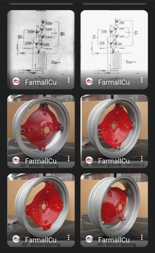

Plenty of options on cub wheel spacing.
Flip those rims and tires into a dozen
different configurations....
Just keep your square head bolts in the
square on the rim...... doesn't matter if
they are in the inside or outside.
Keep the square head of the bolt in the
square in the rim??! Doesn't matter if
they are in or out. It's part of the cub
design. Multiple tire spacing for
different crops.

I'm sure you've realized by now that the bolts come out, and can be reinserted from either direction, but for the record... The bolts can be removed and reinserted from either side.
Yes, I realize that. For my needs, I simply want to leave things as they are. This tractor is never going to be driving in fields among rows of crops, so it matters not to me how the bolts go in at this point.
