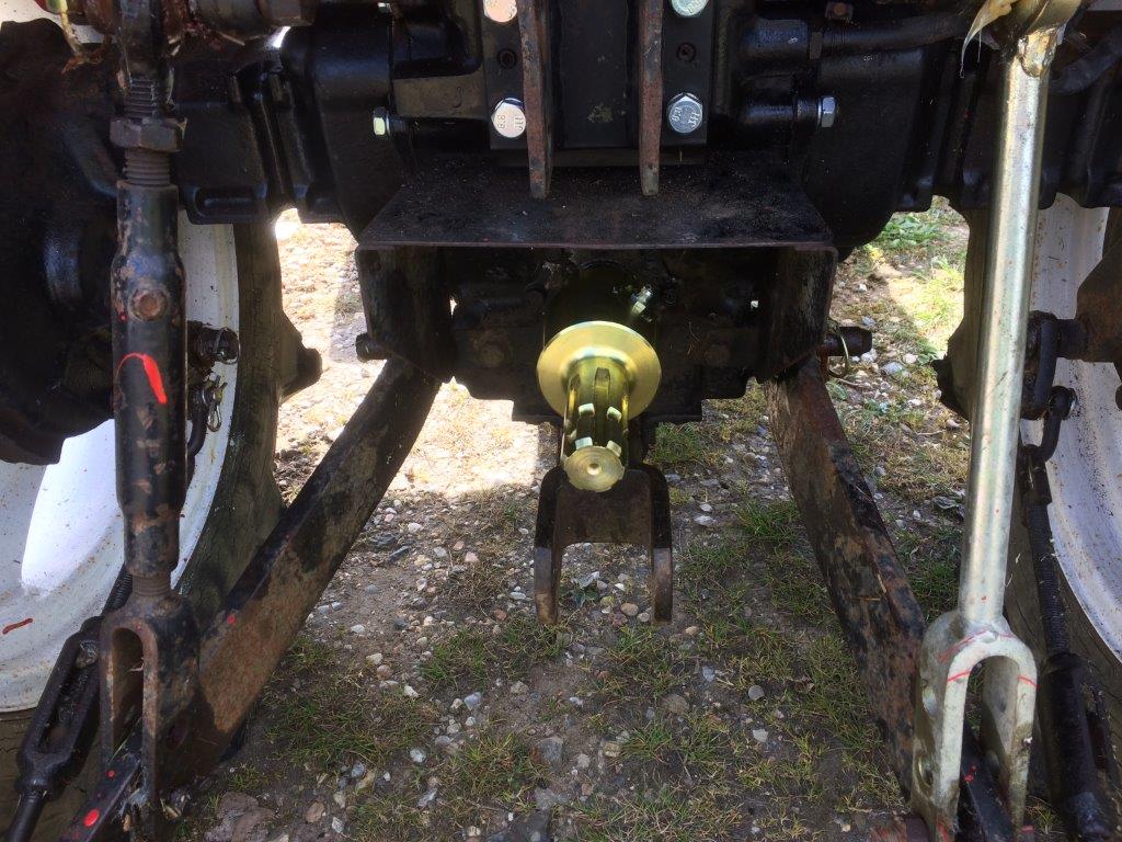

Wondering if you have been running yours without an over run clutch on the pto??
Hi Winston, I am very much a newbie to this. What is an overun clutch ? I just have the PTO shaft coming out of the back of the rear of the tractor. I apologise in advance for my lack on knowledge.
This is an over run clutch. http://www.hoyetractor.com/PROD/OR-660.htm
It allows your pto to free wheel when you stop your tractor. Tractor Ernie, a former tractor dealer and very sharp on these old tractors believes running without an overrun clutch on these is possibly the cause of knocking out the ring and pinion on these models. I know the one I worked on did not have an over run clutch. It does now. You need one for safety if no other reason if using a rotary mower or any pto driven implement that has flywheel momentum.
I did not know about the o-r clutch protecting drive gears. Mine came with a factory o-r clutch; don't know if that's because it's an export model.
I believe all the export models have the internal over run clutch. Talking about the old export models, pretty sure the new generation has live pto's. I tried to find tractor Ernies comment on it but unsuccessful so far.

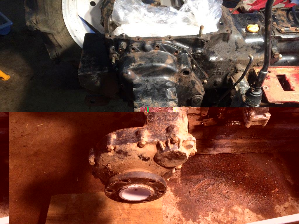

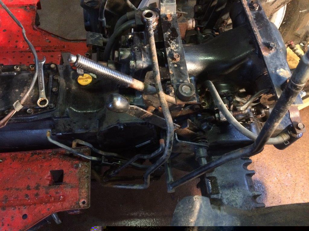

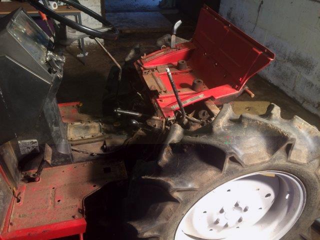

Ok pic one shows my F20D before starting work and Pic two shows her with most of the tinware removed.

There is no differential lock on the front axle. The pedal is for the rear wheels. The front wheel with the least resistance will spin. That is normal.
If no rear drive with diff. lock engaged then might's well check ring an pinion. You were questioning operating with only front drive, a good way to destroy it. You app. still have prob. of turning off FWD.

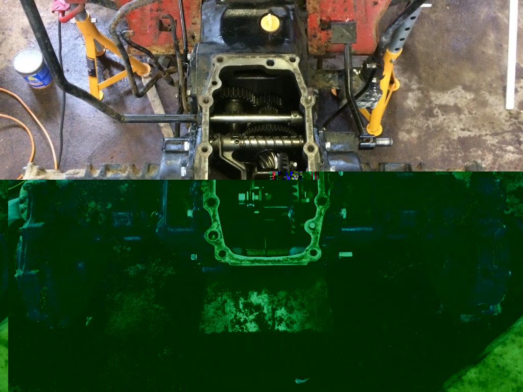

Hi Guys need your help again. I have now stripped off all the tinwork and cleaned the gearbox back axle area. I have undone the 9 bolts and the one nut hidden under the hydraulic pump. I have disconnected the handbrake and over levers that are mounted on the upper housing that I need to lift off to view the ring gear Below. Problem is I cant shift the upper housing. Is it just a case of giving it a tap with a mallet around the joint or have I missed something ?
The housing has a couple of dowel pins that will allow it to move only straight up. The gasket will also likely stick it somewhat. I would tap around it real good, then use a sharpened tool to get between the housing and cover. Likely have to use a hammer to drive it in just a little. Take your time, once it starts coming up a little at any point then work your way around it bringing it straight up and not cocking.
That cover will be heavy so be ready.

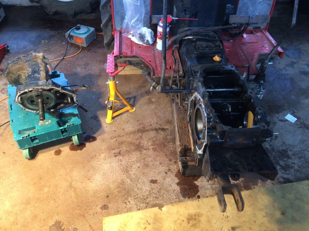

Ok we are getting somewhere now. large casting has now been lifted off ( you weren't joking Winston when you said that was going to be heavy ! ) I ended up refitting the upper three point linkage upside down so that it only went into the top casting and then used a trolley jack to push against it. Popped off a treat. I have checked the ring gear and there are no bolt heads showing at all on the reverse and it spins freely. Guess they have all sheared off and are sitting in the bottom of the sump ? The ring gear appears to be undamaged and the pinion gear appears to be in good condition. Next thing to do will be drain the oil and then get the wheels off and get it jacked up ready for next weekend when I can take the two rear axles off and remove the diff. What do you think the chances of reusing that ring gear is going to be when I have got it stripped and can see the reverse ?
"If" the bolts are all stripped and no gear damage it might be possible to put new bolts in and go back together. I think the right axle is the only one you would have to remove in order to get the differential out.
I suspect high speed shifting and or not overrun clutch on the pto stripped the bolts. If you could get by with only new bolts you would be lucky. Make sure you look at all pinion and ring gear teeth closely.

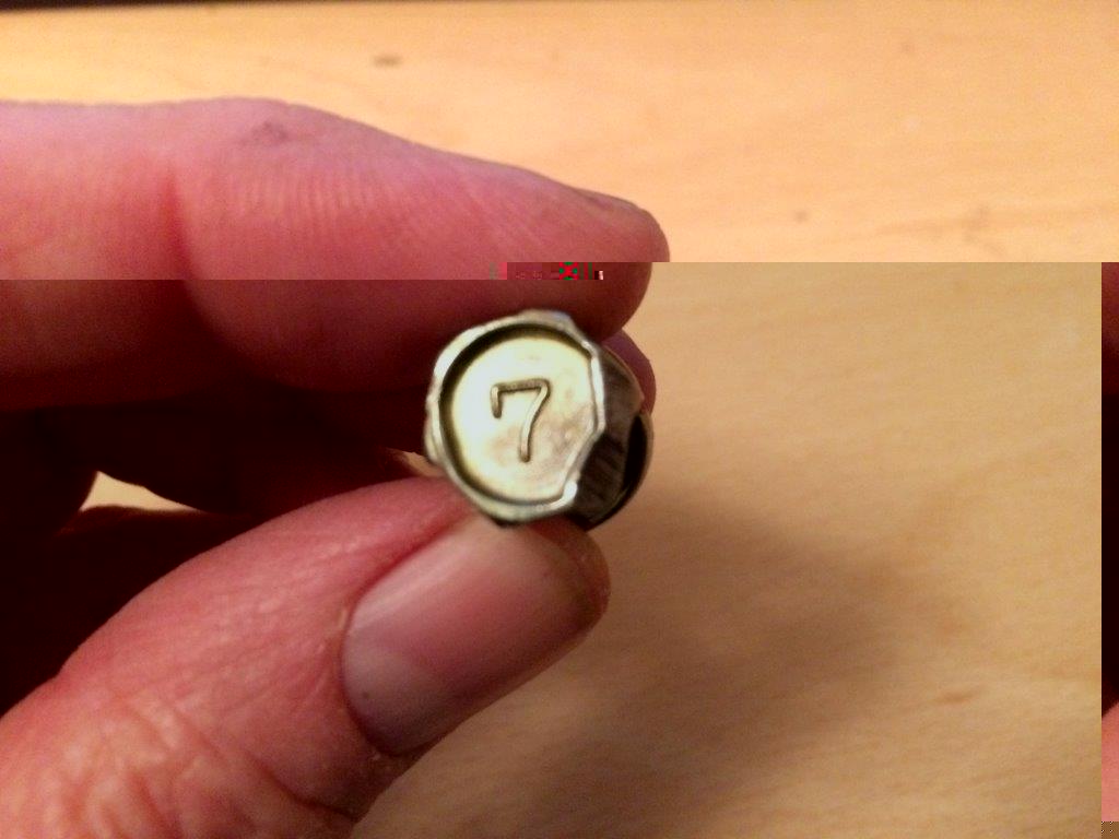

Do I need to buy "special" bolts to fit the ring gear back onto the mounting plate ? are they shear bolts designed to break underload and protect the rest of the drive train or just too soft for the job ? I will be back in the workshop next weekend when I will be taking off the axle and hopefully removing the complete diff and starting the hunt for the missing bolt heads.
When you find the missing bolts there should be a number stamped on the heads. Likely a 7 which stands for grade 7. I guess you could call them special.
Yanmar part number for the FX24D is 26016-080202, they are M8-20. Yours might or might not be the same. My memory is not real good but I am thinking I bought some at a fastener company like Fastenal or such.

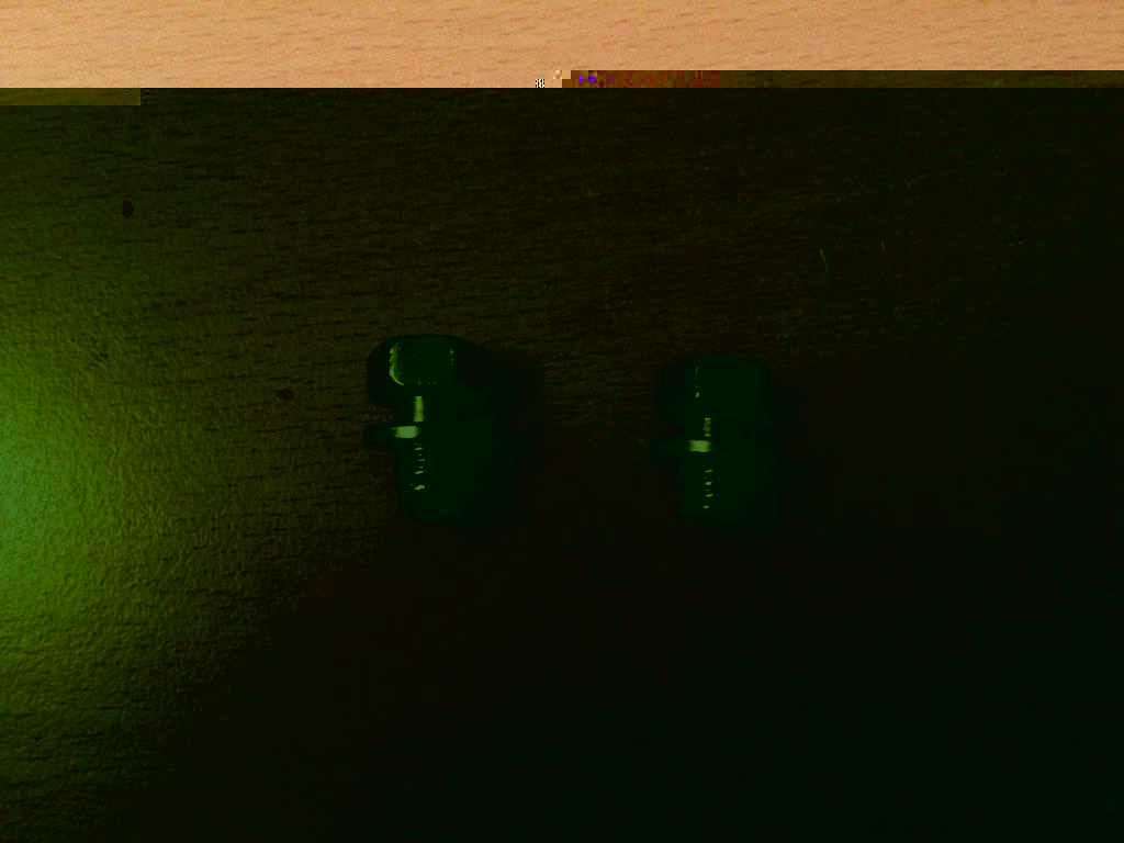

I have use Walmarts Supertech transmission/hydraulic oil and have used Tractor Supplys Traveler brand transmission/hydraulic oil. Here are the specs for your lubes. <LINK_TEXT text="http://www.hoyetra...pport/knowledgebase.php?article=1</LINK_TEXT>

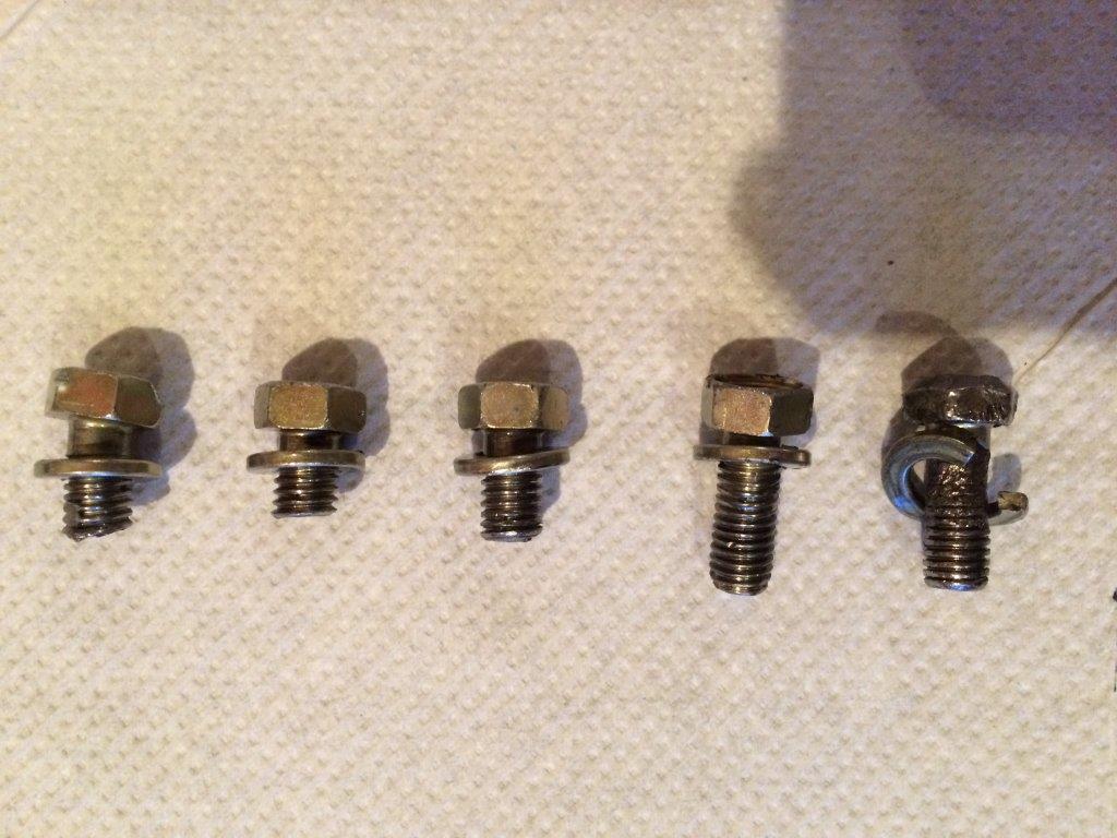

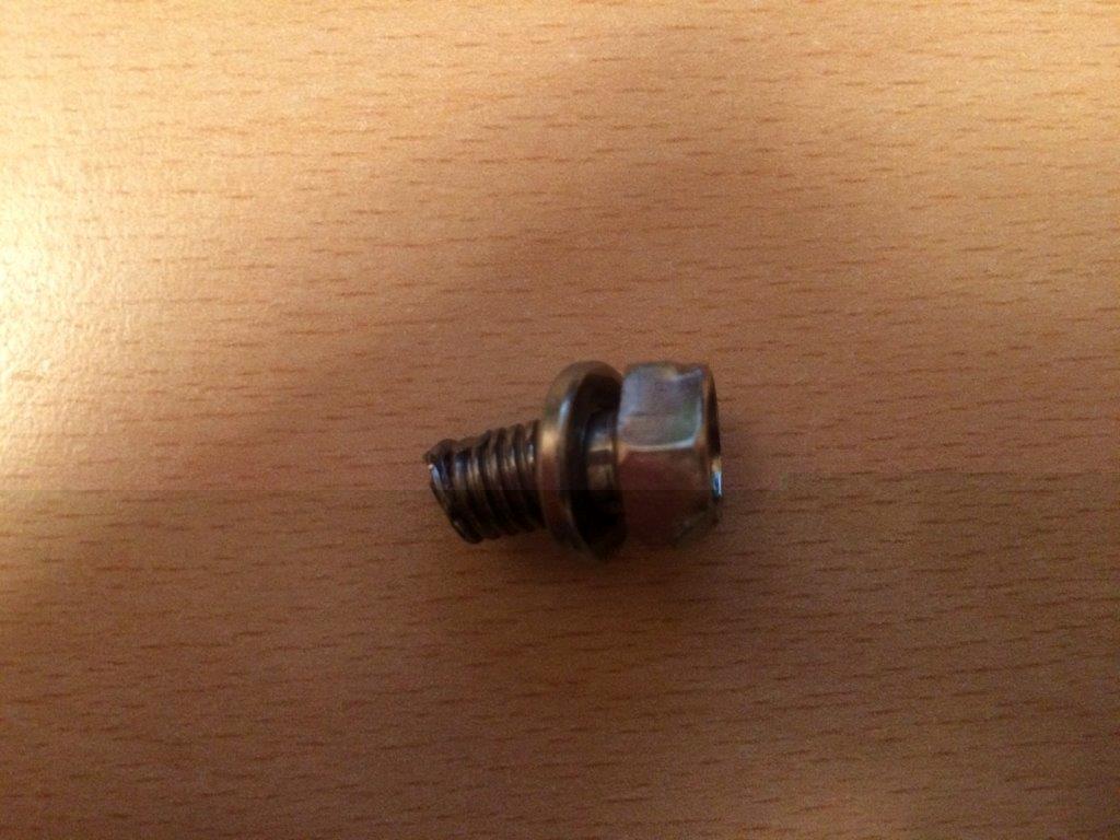

Fished out some more bolts from the sump. I now have a total of 5 with there spring washers. But no sign of the other 3 ( I think there is 8 in total )
<QUOTE author="winston"><s>
</s>I am guessing that is a 1.25 thread pitch. You probably know but that indicates 1.25mm between threads.<e>
/e></QUOTE>
That bolt did not fail, it loosened and backed out until it beat itself to death. The stock bolt , with Loctite should be fine.

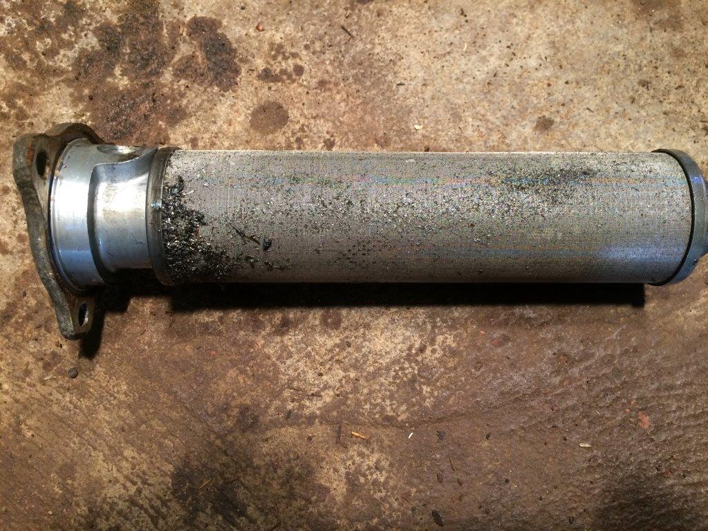

Removed the gearbox filter to gain better access to the sheered bolts and it certainly does need a clean up.
Ok need some more help please. I need to get to the ring gear on the diff to replace the sheared bolts. To do this I am trying to remove the right hand axle. I have removed all the bolts that I can see and the Diff lock lever. The thing is stuck solid and will not move. Any ideas ? As I am only trying to remove the diff can I undo the housing that the wheel mounts onto and then slide out the half shaft freeing the diff that appears to only be mounted on a splined shaft.
There will be dowel pins holding the axle housing in an exact location. The gasket will also be stuck. It is my belief your axe shaft is splined and should come right out of the differential. The shaft should pull out of the differential side gear.

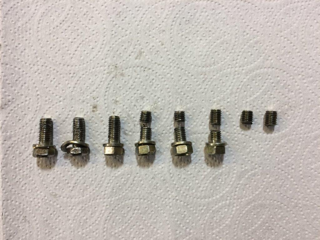

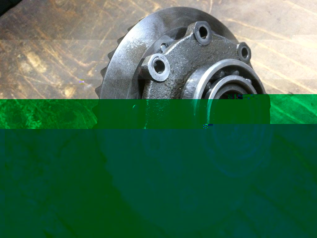

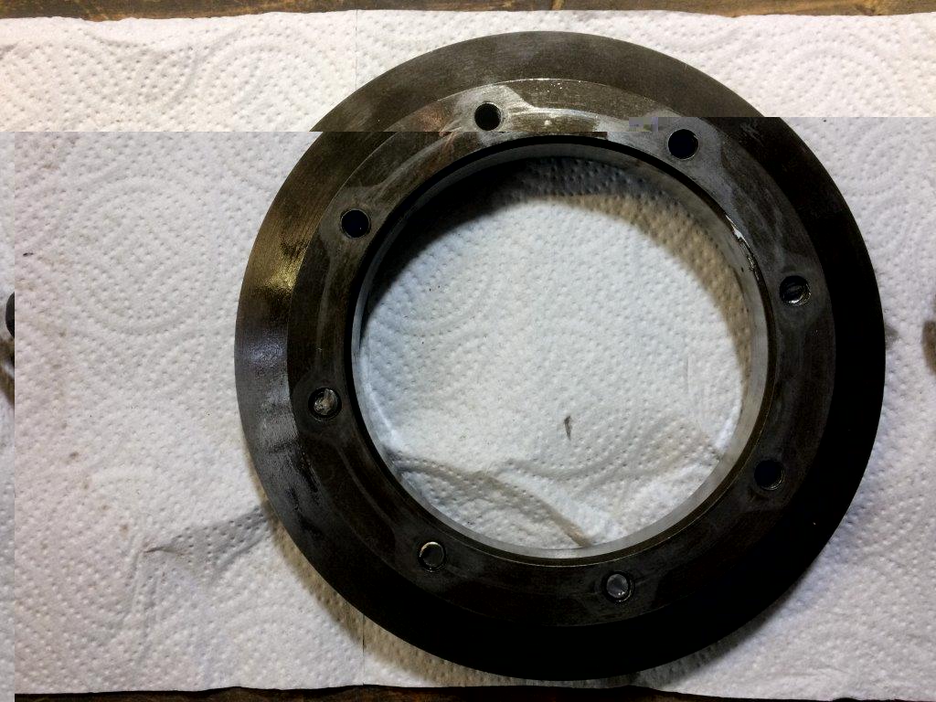

Diff is now out and on the work bench. Ring gear shows the remaining stubs of the sheared bolts, these easily came out just by tapping them round with a pointed bradle.
The ring gear appears to be in almost perfect condition with even the threads on the back usable. The pinion gear also looks good. Is there anything else that needs inspecting prior to rebuild or is the damage likely to be focused purely on the ring and pinion gear.
and now the fun starts. I have fished out most of the missing bolts and matched them up but am missing two halfs. the search continues......
Very poor workmanship for a Japanese, (or any), factory. Don't they have Loctite thread sealer over there. I have read of the happening a couple of times over the years.
<QUOTE author="passy"><s>
</s>The ring gear appears to be in almost perfect condition with even the threads on the back usable. The pinion gear also looks good. Is there anything else that needs inspecting prior to rebuild or is the damage likely to be focused purely on the ring and pinion gear.<e>
/e></QUOTE>

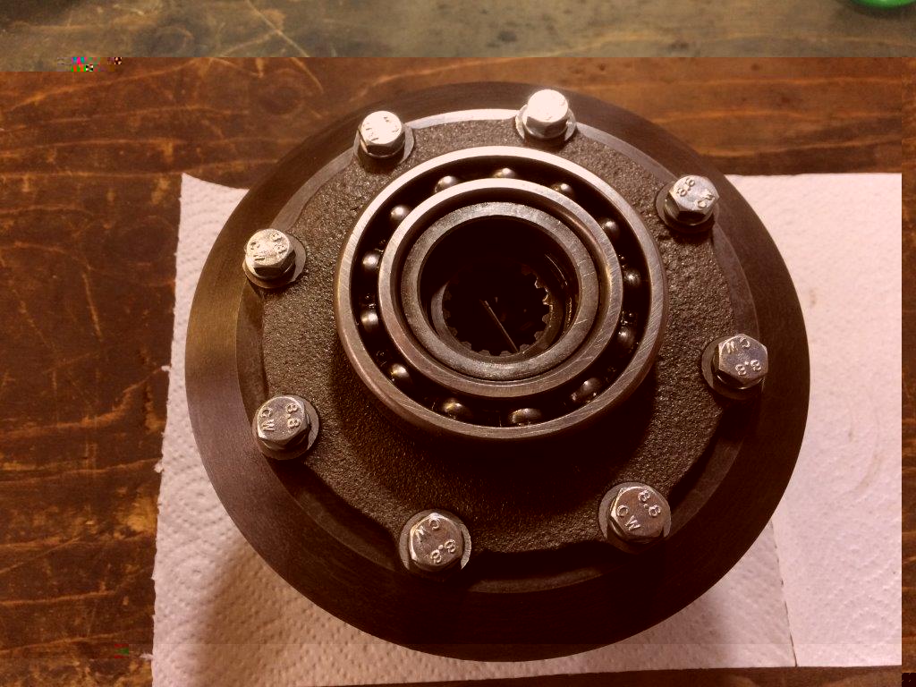

I would go back together with it. Looks to me like shock load caused bolts to loosen/shear. I would locktight as Paulw suggested and install an overrun clutch for mower usage. The 276 service manual shows m8 bolts on the ring gear and a torque value of 43 ft lbs. Would also try to put the ring gear on the carrier in the same bolt holes it came off. Manual suggests this. For what it is worth the 276 manual does suggest using locktite.

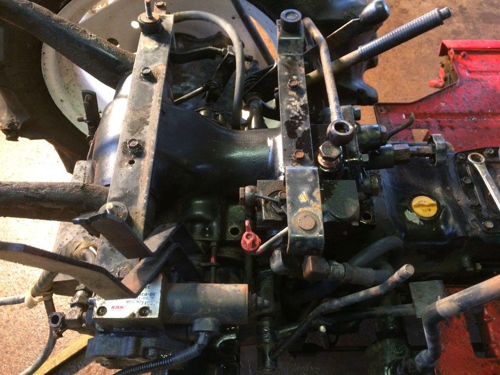

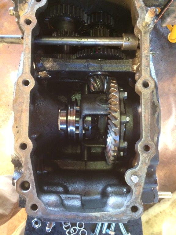

I am a bit stuck now. strip down has gone well and I am almost to the point where I can start the rebuild but I cant find the last two remaining bolt heads that must be hiding in the gearbox / sump somewhere. Question is I am going in through the dipstick hole and the oil filter hole on the side with my magnet. is there another chamber behind the next bulkhead I need to get access to or is that the clutch housing and will be dry so now way that the bolt heads could have worked they way to ? I am getting close to thinking I can rebuild with out tracking the two missing bolt heads down but I know that is taking a big risk of them suddenly bouncing about and dropping into a spinning gear.
I am totally dependent on the pictures you post. I see a side cover on the left hand side but no idea what you could access through it. You tell me. Is the top cover I see right in front of the dipstick part of the clutch housing. The clutch housing will attach directly to the engine. The next break or bolted together housing would be the start of the transmission.
Hi Winston, I hadn't spotted that side cover on the left hand side. I will remove it tonight and see if it gives any better access. cheers

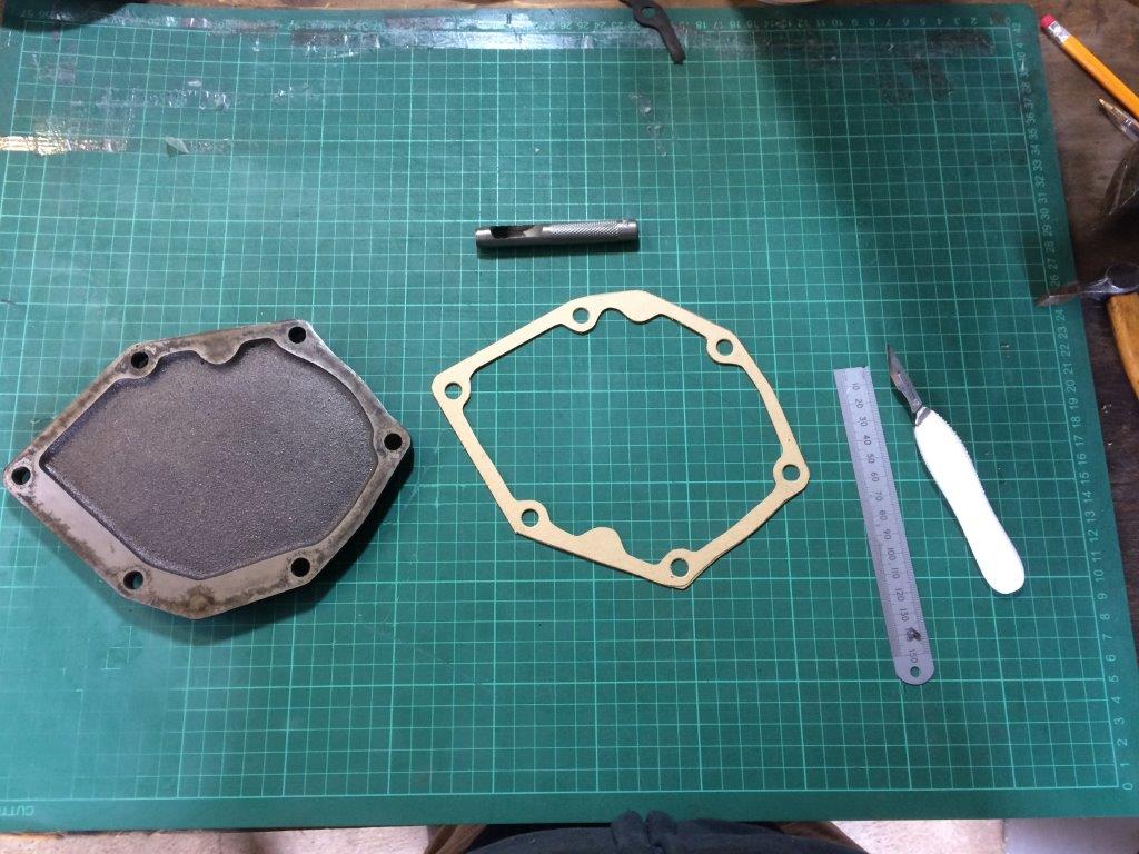

Back to the workshop tonight and followed Winston's advice about the small access plate on the left hand side of the tractor and there were the last two sheared off bolts sitting in the left hand side of the sump. Now I can start work on the rebuild.
The first of the new gaskets made for the small access plate which has now been refitted. Is there any easy way to remove the old gasket residue that is on the main castings or is it just a case of working away with a scraper ?
The next major job, after I have scrapped all the residue off from the old gasket, is to remount the two axles. The gasket paper that I have got is fairly soft and approx 1mm thick. Would you recommend using an RTV silicone on both sides or just fit dry ?
I am now starting to put things back together again. Diff if is back in and I have just refitted the left rear axle ( seen as if you were seated on the tractor )Now a question. Everything feels good, everything turns freely when put in to neutral, but when I turn the ring gear by hand the pinion gear turns but the axle at the point were the wheel does not turn. This will only turn if I engage what I think is the diff lock. Is that correct ( maybe I am looking at it the wrong way round and I am actually disengaging the diff lock when sliding over the small round wheel that has the points that lock into the gear ? ) should both rear wheels be driven all the time, have I missed something ?
If I am understanding correctly then yes, that is normal. If you were to look at the splines on the right hand side of the differential you should see them turning. Least resistance will turn.
When you gently rotate the ring gear back and forth you should notice a few thousands backlash between it and the pinion gear. Do you have that?

All assembled now with tin work back on as final job. This was made a lot easier as I bought a load of new bolts that were exactly the right size so no messing about using old rusty bolts. Job was finally completed for less than $150 as there was no damage internally apart form the bolts on the diff being shredded ( most expensive thing was the oil for the gearbox at $90 ! ) Big thanks to Winston for his guidance at some crucial times during the tear-down and rebuild. Tractor now drives smoothly on all four wheels !
Hi Norm. the drive shaft that I am using slides in and out of itself and with the new ORC on just means that I don't have to pull it out quite so far. I assume that this will be ok ?
Hi Norm, ok I understand know. The shaft looks like it all fits ok when the bush hog is sitting on the ground but as you lift it the shaft needs to be able to reduce in length and if to long, Bang !
