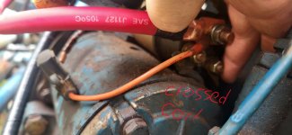

Hello everyone need some education please. Ford 3600 that was running great yesterday, went to run the tractor today and it turned over once and then almost like a fuse pop/click and then no engagement of the starter.
The battery cables have been on my list to replace to I pulled them, cleaned them and it turned over 1 time and did the same click with nothing after.
To rule them out I built new battery cables with new wire, new terminals and ring lands and did a quick charge on the battery.

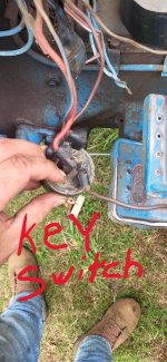

My question is how to do I properly diagnose a bad key switch vs the coil. For troubleshooting I also have the neutral safety bypassed to rule that out.

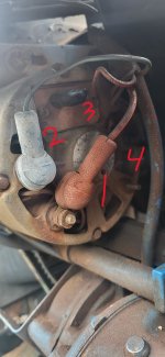

I have a 4 wires at the switch, Main power source to fuse link (fuse tested good with volt meter). I have 12.6v on the positive and ground side of the ignition coil and key switch, I also have voltage and ground at the alternator

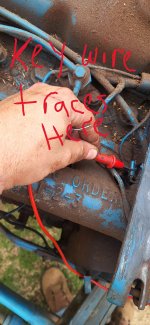

I'm a little confused what my 4th wire on my key switch is I have main power leg, ground leg, neutral safety wire, 4th wire seems to go to a sensor on the manifold past the 3rd cylinder (picture attached).
With the key in the run position and crossing the power at the coil I still did not get engagement of the starter.
So now I'm wondering could it be as simple as the coil? How would I test this switch I was expecting to see 12v go across the 4 terminal but I do not voltage is very low (that when I ohm/traced the 4th wire to that manifold sensor?)

You mention the ignition coil again further down, which makes me think that it has a gasoline engine. There should be no 4th key switch connection if it is a gasser. If it is a diesel engine, then the 4th key switch connection is most likely for the thermostart cold starting aid.

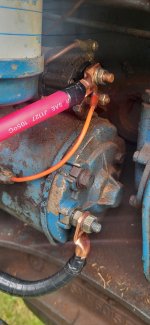

Yes I'm probably mixing the terminology up, solenoid sitting on top of the starter. Battery positive wire to the solenoid, and the hot/main fuse link goes to the key switch from the same terminal.

HIS TRACTOR IS A DIESEL, look at “4th key wire
picture diesel injectors are pictured. Since I am
not a died in the wool Ford guy I am not 100 percent sure but I believe that wire operated a thermal starting device that heats the air in the intake manifold to aid in cold weather starting. Now I see Sean answered that.
In your picture that says “coil wiring” that is not correct that is the “starter solenoid” the highest connection terminal with the screw is what should energize when the starter is turned to the start position. Checking that this is working should be your first step. Additionally this is a short cut, be extremely careful making sure the tractor is in neutral before trying this, this activity has killed people. Jumping from that terminal to the large one just below it should engage the starter. If you get no response, I would suggest getting the battery tested.
To help you with proper terminology I am attaching the manufacturers parts catalog for your tractor. CNHI Ford 3600 parts catalog
