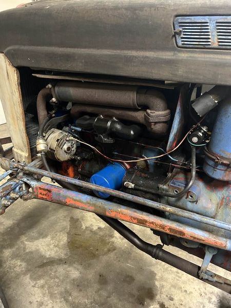

I'm confused. The Casting number on the block is 310905 and the stamped numbers are 41201 and 71068. Please tell me what this is.
Your tractor has had a engine or transmission swap
310905 is a 134 ci engine block number that would have came in a 58-59 601 model
The transmission model code and serial numbers are for a 4000 model with 4 spd trans built in 1964
Post some photos of your tractor, side view, dash, rear axle
View attachment 94721 Tractor Dash.jpgTractor Hood.jpgWheel.jpgTracctor Engine.jpg
I like the color scheme :rolleyes: . That is definitely a hundred or '01 series grill and hood, so the engine is probably original and the trans has most likely been swapped with one from a slightly later 4 cylinder 4000. They used the same 4 speed transmission from 1955 through 1964. So yours is a 641 for all intents and purposes.
Thanks for your help. It makes ordering parts a little easier. A friend gave it to me so, the price was right. Motor runs good and trans seems ok. I'll get her painted this winter.
