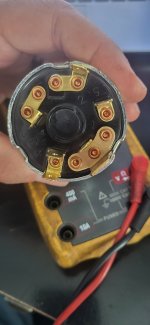

Key has 3 positions and start - Off, 1 turn, 2nd turn, start
Power is at terminal 1
1 turn of key and I have continuity/power at terminal 2
2 turns of key and I have continuity/power at terminal terminals 1, 2, 4
Turning the key to start I have continuity/power at terminals 3 and 5
Please help me confirm if the wiring below would be correct

Position 3 (first springy position) is for pre-heating, only the Thermostart is engaged.
Position 4 (second springy position) is for cranking and heating at the same time, both Thermostart and starter solenoid are engaged.
One thing to think about with this type of key switch is that there is no position for cranking without the Thermostart engaged. You should not use starting fluid, rag with gasoline or anything else flammable to aid at cold starts, without disconnecting the wire for the Thermostart first.

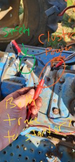

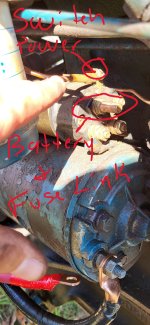

Here is what my starter looks like also what I have been able to trace out.
The thermostat sensor, traces to a green wire with blade connector that connects to the instrument cluster directly.
Intake heater by the manifold directly runs to the key switch.
From key switch, 1 wire sends power to the instrument cluster via blade connector, it also supplies the the positive side power of the oil pressure light bulb, battery charging bulb, and what I think is the dry intake sensor light bulb. This wire I put on terminal 4 to power the cluster.
THIS IS WHERE I'M GETTING CONUSED
That same wire from terminal 4, shows continuity to the starter solenoid. I don't see how this is possibly. I can put my volt meter on OHM with sound and I get connection from the blade connector to my starter?
The safety solenoid wire (terminal 5 on key switch) also shows connection (as expected) from the key terminal wire to the starter solenoid.
This tractor was working perfectly fine until it just seemed to loose all power beyond my main fuse link. I don't believe my power wire to the cluster should be showing a connection to the starter this is what was meaning by could something be grounding or shorting out, but I can not find anything. The only bare spot I have been able to find was on the ground side of the dry intake sensor.

Measuring continuity is not a good way of checking wiring that you are unsure of, especially when they are connected to other things. One side of the primary of the solenoid is grounded, so the continuity that you are seeing from that terminal on the key switch is likely going through one of the wires on to ground. Remove each of the wires from terminal 4, one at a time, and measure continuity to ground to see which of those wires is providing the path to ground.

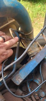

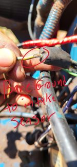

UPDATE
I got it going I appreciate all the help gentleman! I learned a lot, best I can tell this intake sensor was somehow shorting me out with the nicked wire underneath the fuel tank hood..

Also Sean, I used the test light on the starter solenoid it's getting ground with the key off and I'm guessing when going through the starting process that's when key switch/neutral safety sends power and it turns over the starter. I guess I need to do a little learning on how those internals actually work and power and ground actually flow through them.
