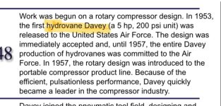

Looks like this design was a big breakthrough in air compressors back in the day. “Hydrovane.” Not sure how it made pressure but it’s not a piston compressor like I’m familiar with. I think it’s probably been sitting as-is since the 1960s. The man I bought it from is pushing 90 and it was his dad who bought it.

Vane compressor, we had a old 69 model Worthington rotary vane compressor at the mill with 20 hp electric motor, it would flow 100 cfm of air at 100 psi, the screw compressor we replaced it with used a 25 go motor to produce the same volume and pressure, we keep the old vane compressor as a backup

Must have been running alcohol gas it's all gummed up . Better use that straight gas for this. So now is a vane the same thing as the screw compressors being raved about now days. Or are they more like a vane hydraulic pump?
