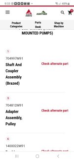

We are working on about a 1956 202 Massey Ferguson Industrial.
Was wondering if anyone had access to the parts catalog for it. Was looking for some OEM part numbers.
We found the parts on this site that we need, but we are looking for the original part numbers.
The part that we are replacing is the coupler plate and shaft on the front hydraulic system.

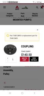

When I do a search on this site, the one that comes up that looks like it is: (Item #: 118288, Ref: 704812M93)
Called the “Lift pump adapter plate”:
And
Are the item numbers listed the correct OEM part numbers for this machine from a OEM parts category?
Thank you!

The parts you posted are correct. I purchased the shaft from this site. The only issue was the coupling rubbing on the bolster. I cleaned it up with a grinder and no further issues.
What the current part numbers are is somewhat confusing. My 202 is a 1957ish. I believe it's a Davis 102 loader. At some point M-F bought out Davis. So.... AGCO calls it a 200 series. Jim might have some imput here.
All this is really a mute point as AGCO has very little parts available for this style loader. The spool valve, hose assemblies, and filter are long obsolete. Any good hydraulic shop can make hoses and repair cylinders. An after market filter can be fitted. The hydraulic pump is a standard SAE configuration.
I looked through the parts book and I believe the numbers pictured below to be correct for a 202. (The parts you posted ARE correct)
Without knowing the model, a parts book is marginal help at best. A number of the drive parts are common across many models.
Like you, I expect the ones he posted will work. In general, with the aftermarket parts it comes down to does the drive plate bolt up to the crank pulley. Then is the shaft the right length, does it fit the drive plate and does the other end match the pump shaft (And does it fit through the hole in the axle pin?).
