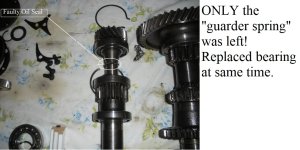

My parents purchased a new MF 35 X in 1963,with the Perkins diesel engine,6 speed transmission,(3 forward gears plus H/L range) and differential lock.
The engine was totally overhauled in 1984/85 and had run approximately 100 hours,when I retired and claimed the Tractor from my brother in 2013.
The Transmission had never been mechanically worked on,same said for the three point hitch HYDRAULIC PUMP,as well as the dual clutch,pressure plate assembly.
All oil drain plugs in the "common Transmission,Hydraulic,Differential oil sump" had cuttings attached to the magnetic chip detectors.
I removed the Transmission,installed Transmission on a work stand,stripped the transmission,and invested more than $2000.00 dollars (PARTS) as many components were NOT serviceable.
I had purchased an original parts catalogue (eBay)and still had the original MF 35 service manual......................:)
The dual clutch assembly had NOT been adjusted properly over its entire life,and the clutch assembly was NON serviceable!
The three point hitch lift arms would jump and jerk as they moved up or down.
Upon inspection,the pump had been subjected to moisture,thus the pump was non serviceable.
After the above was totally repaired,the Tractor runs perfectly!
All parts were available,and fortunately,"YESTERDAYS TRACTORS" supplied many NEW OLD stock parts...:)
Cost of new DUAL CLUTCH assembly ?.......several hundreds of dollars in 2021........
Cost of new Hydraulic pump assembly ?.. $243.00 dollars in 2017
The Tractor you are describing, is $350.00 or less!
Tractor, POSSIBLY could be purchased, parted out and make a profit.
"IF" the Transmission has to be dismantled,and "IF" you have never done such an undertaking you are in for an EDUCATION........!
NOT all MF 35's 6 speeds have the same internal components.
A PARTS catalogue is a must.......
The Serial # of the MF 35 is a must to KNOW,to identify correct internal components in the Transmission...
Case in point:
Some MF 35's ran the engine at 1500 RPM to obtain 540 PTO RPM
Other MF35's ran the engine at 1700 RPM to obtain 540 PTO RPM
Different gears in the above to obtain Standard PTO speed..
