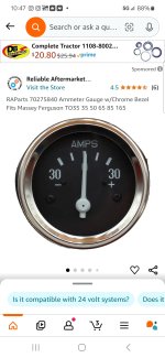

Stan, can you tell me what the Ammeeter looks like, or where is it located ? under the dash? I will use your troubleshooting, butat first glance, it appears that no current is getting to the Ignition.
The ammeter is/ was in the dash. I think all of the 202s had them.
Generic picture:

Stan, since the tractor is 123 miles away, and the nearest hardware store is over an hour, I'd like a way to by pass things such as the ammeter. Is there a way to direct wire the whole shebang direct from the battery to the Ignition?
The ammeter is just a gauge, showing you electrical current, so is not imperative to the tractor running. If you have one in the dash, just move all the wires onto one of the two terminals of the gauge. You'll just be using it as a connection block for all the wiring, instead of running the current through the gauge. That will take the gauge out of the equation. The shortest shortcut is to run a hotwire from your battery hot (+) directly to the (+) on the coil. This will get you current directly to the ignition system. Then all you have to worry about is turning over the starter, which it sounds like you can make work. Just don't leave the hotwire on after the tractor is no longer running. It will drain your battery and may destroy your coil.

Stan , your troubleshooting led me to the Ammeter. I think it was either corroded, or shorted. So I joined the two wires, and rewired the old wiring according to your diagram, and it fired up right away ! Thanks
Bill, that's good to hear! I don't think I've ever had an ammeter fail like that. I would try to clean up the terminals and see if I could get it working again.
If you choose to replace it, stay away from the $20 junk. It's an exercise in futility. VDO, Stewart Warner, or Autometer. I'm not sure if Autometer is still making any ammeters. Autometer 30 amp Marine preferably.
I like an ammeter with the old mechanical Voltage Regulators. I can watch the contacts "close in" when the battery is being charged. I can also bump the engine around and tell if the points are closed. I would likely check ebay for NOS.
